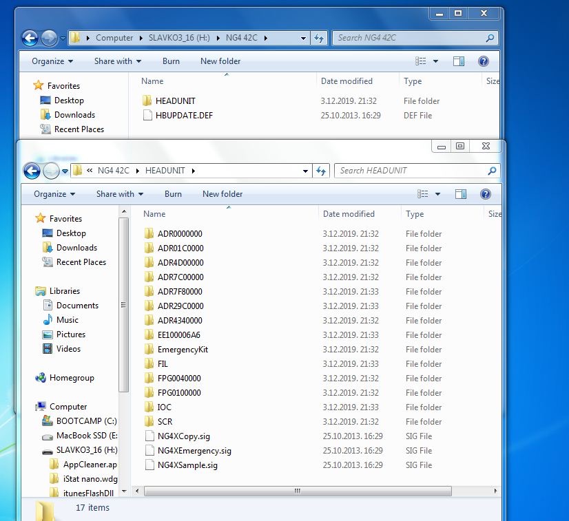

Best to update from USB - after you remove the CD. The DVD drive takes priority over the USB, so it you have a CD in there it will keep trying to read that before the USB.
Can you put a screen shot of the USB content here for me to see which files you have so I can check they are ok.

It is for my friends RCZ who asked for help...
Here is the ScreenShot of the Firmware content that I used.
It goes on the root of a FAT 32 formatted USB2 key. All done on a Win7 PC.
The HDD is automotive Toshiba HDD (30 or 40 GB). I'll share the photo as soon as I get it. But now I think the problem is that HDD wasn't FAT 32 formatted prior to installing into the NG4?

1) So the files look correct - no other files and the order is correct.
2) I notice that from the screenshot that looks like a Macbook from the directory listing - even with Bootcamp these can put hidden files on the NG4 Hard Drive & USB that will cause problems. I suggest you show all hidden and system files and make sure there is nothing other than those files for the firmware as shown for the USB. Same goes for the Hard Drive.
3) Once you are sure all the files are correct and the CD is ejected, you need to follow the battery disconnect on your friends Peugeot using this guide (up to the battery disconnect part). Once the battery has been disconnected remove the NG4 and install the hard drive. Put the USB in the car's USB port.
Please note always remove the quad lock from the back of the NG4 first before any other connectors - especially the screen connector - and then replae in reverse order.

I'm about to do the hdd-cf card conversion thanks to your guide. Im only missing the card itself.
Do you still recommend these "Komputerbay" cards? On amazon.de it has a 55% positiv to 32% negative review ratio.
Also would you kindly send me the latest ng4 firmware files?
