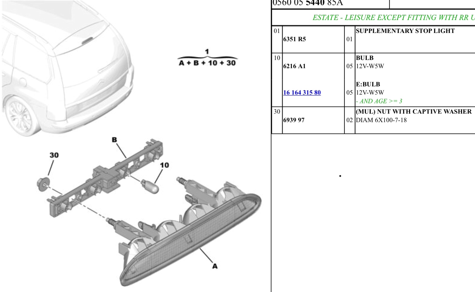

You’ve not read the thread properly and taken my answer out of context.
I’m talking about when people replace halogens for LEDs when the lighting system on the vehicle is not designed for LEDs! This WILL result in bulb out warnings or rapid bulb flashing as they are not designed for the electrical system, unless the user also fits load resistors.
That’s why I suggested the OP check the other lights to see if a previous owner has replaced them with LEDs - and if you read the previous posts, you would see that the rear number plate lights have already been swapped for LEDs.
LEDs were not fitted to this vehicle....... it’s thenlens that is made to look like it has LEDs for effect only.
Also, although you may think high level brake lights are fitted with LEDs, on most models (including this one) they are not. They just look like it but in fact take standard W5W bulbs in the high level brake light......
And here’s the evidence in case you won’t accept my answer.....
W5W bulbs on a 2010.

Very impressive but I kinda think they won't pass the Construction and Use regulations!
