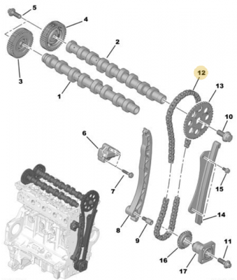

Ok, so I was nearly right, you have a NEMO UTILITY VEHICLE VAN 1.3 HDI 75 Manual gearbox 5.
This has a timing chain - so no belt, and as such doesn't need changing unless there is a problem with it. What is important is frequent oil changes as the chain is inside the engine and gets lubricated by the engine oil.
Item 12 on the diagram:
Hope that helps.
