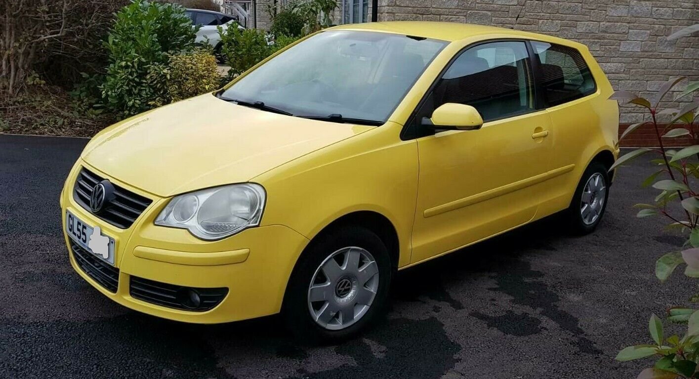

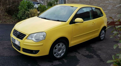

Job done with a replacement for the Micra, into which an awful lot of hours went: this lovely is now hers, well pleased!
