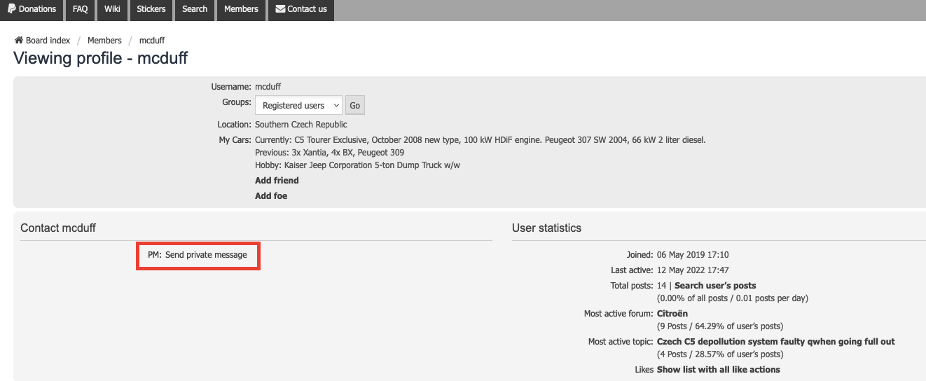

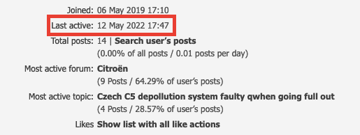

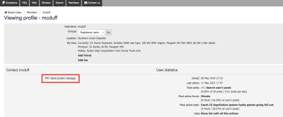

The user mcduff was last online in May 2022, so we don't know if the problem was solved...
Maybe you can send the user a private message here:
memberlist.php?mode=viewprofile&u=27040
