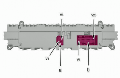

Apart from the air mixing stepper motor being at fault - another possibility is the actual A/C control panel itself. So what you could do before spending any cash it to check the connector - specifically the 26 way connector - channels 6, 7, 8 & 9, as these control the air mixing stepper motor. I would clean the connector pins with some electrical contact cleaner - has to be worth a shot.
| "a" 6-way black connector. "b" 26-way yellow connector. The automatic air conditioning control panel consists of 2 connectors:
| 26-way yellow Connector Channels | |
| 1 | 1 phase signal: Air intake stepper motor |
| 2 | 3 phase signal: Air intake stepper motor |
| 3 | 4 phase signal: Air intake stepper motor |
| 4 | Supply: Air intake stepper motor |
| 5 | Supply: Mixing stepper motor |
| 6 | 3 phase signal: Mixing stepper motor |
| 7 | 4 phase signal: Mixing stepper motor |
| 8 | 1 phase signal: Mixing stepper motor |
| 9 | 2 phase signal: Mixing stepper motor |
| 10 | 4 phase signal: Distribution stepper motor |
| 11 | 3 phase signal: Distribution stepper motor |
| 12 | 2 phase signal: Distribution stepper motor |
| 13 | 1 phase signal: Distribution stepper motor |
| 14 | 2 phase signal: Air intake stepper motor |
| 15 | - |
| 16 | Signal: Blown air temperature sensor (Left hand ) |
| 17 | Earth: Evaporator temperature sensor |
| 18 | Sensor signal: Evaporator temperature |
| 19 | - |
| 20 | - |
| 21 | signal: Sunshine sensor |
| 22 | Earth: Sunshine sensor |
| 23 | Blower diagnostics connection |
| 24 | Sensor earth: Blown air temperature (Left hand ) |
| 25 | Blower unit setting |
| 26 | Supply: Distribution stepper motor |
