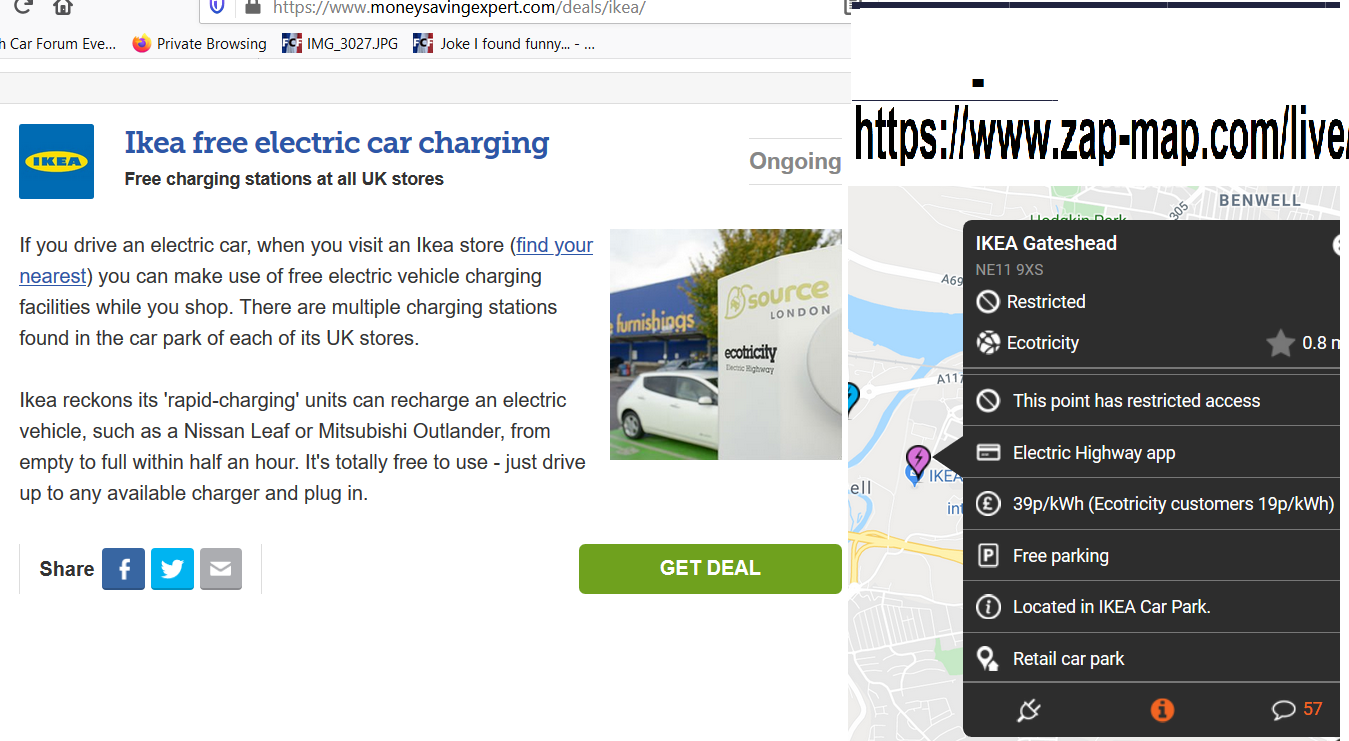

This id from MoneySavingExpert and is described as "ongoing". Never tried it out as being a non-smartphone user I do not have the App for ecotricity who operate the chargers. Lidl originally offerred free charging with their Pod-Point partner but they are chargeable now.
Zap-Map still has the IKEA Ecotricity chargepoint at Gateshead costing 39p/kWh, which is........very expensive.
