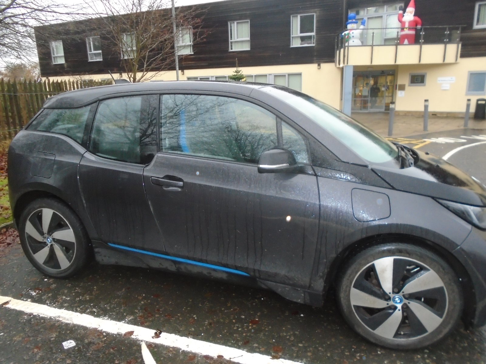

Now this is an I3 but it is one of those with two "fuel" flaps as mentioned earlier in the thread.

Sooooh ugly! (imho) Unusual for a sideview.
