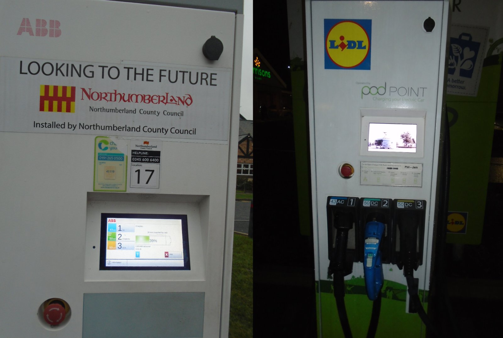

A Tale of Two Chargers.
The NCC rapid chargers dotted at several locations throughout the county are currently free to use, and have the Chademo rapid charger I need for the Leaf.
LIdl have chargers at many of their stores, their partners are Pod Point for which currently you need to be in the Pod Point "club", and have the Pod Point app, and no way of paying at the charger with a bankcard.

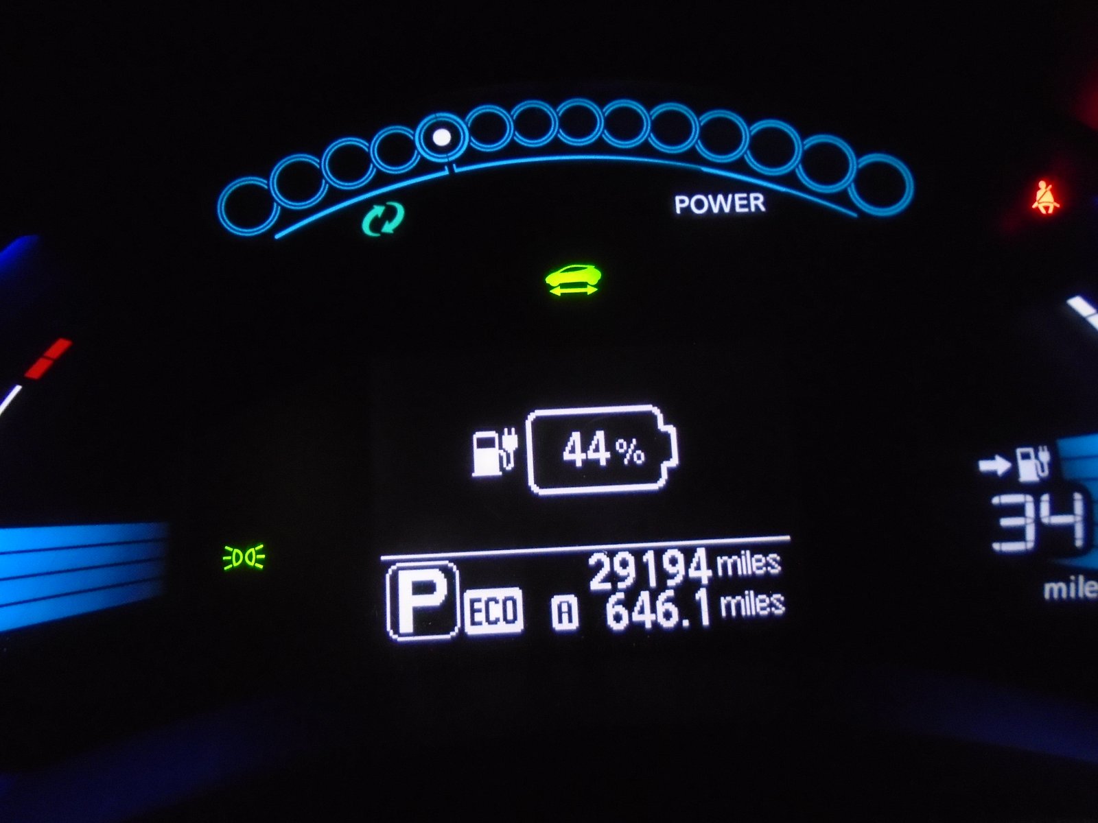

Kicking off our electric vehicle ownership with the odometer on 28,440 on 15th November 2019, as of now it has reached 29,194 and we have 754 miles experience behind us. Had 4 top ups at payfor chargers at just under £5 each on the trip down to Yorkshire, the rest have been free. So for the 754 miles, the fuel bill has been £20 in the two weeks we have had it.
