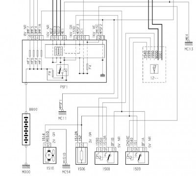

Here's the relevant bit for you:
Hardware
1506: Cooling fan 2-speed / resistance (3 Pin Grey Connector)
1509: Fast speed fan supply relay (5 Pin Black Connector)
1508: Slow speed fan supply relay (5 Pin Black Connector)
1510: Fan (2 Pin Grey Connector)
MC94: Earth
Wiring:
1514: Fan Control
M1510: EARTH m1510
1512A: Fan unit low/medium speed command
152: Fan assembly low speed control
1590: Fan unit relay power supply
1550: Fan control 2 (-)
BF1A / BF1B: Power form Maxi Fuse MF1
1540: Fan control 1 (-)
151: Fan assembly high speed control
Also, bear in mind the fan is usually on low speed if you have the air conditioning switched on.

Re: 2004 VU Berlingo 1.4i (M59) Cooling Fan Issues
As per your PM, here is the injection circuit. There is no pin 84 referenced - but that may just be because a lot of these are contained in one connector - but the 1540 wire goes to the engine ECU as you can see (I think they got the prefix code wrong where it starts 12** on the previous diagram), but goes to pin J4:
Anyway I hope this is what you need.
Bear in mind where there is a dashed line - e.g. going from the engine ECU (1320) down to 1504, you'll see this is also dashed and that is because the cooling systems and equipment can vary on htis configuration - so they show it as 15--.
Not the best of diagrams - but as you can see top left of battery (1320):

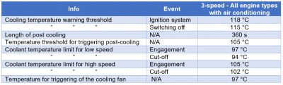

The table should answer your questions, but the post-cooling threshold for triggering the fan is 105 °C and can last up to 6 minutes.
Post ventilation
When stopping the engine, the engine ECU controls the post cooling (slow speed), if the measured engine coolant temperature is over a programmed level.
Post ventilation
| Description | Action | 3-speed (*) All engine types with air conditioning |
| Cooling temperature warning threshold | Ignition system Switching off | 118 °C 115 °C |
| Length of post cooling | - | 360 s |
| Temperature threshold for triggering post-cooling | - | 105 °C |
| Coolant temperature limit for low speed | Engagement Cut-off | 97 °C 94 °C |
| Coolant temperature limit for high speed | Engagement Cut-off | 105 °C 102 °C |
| Temperature for triggering of the cooling fan | - | 97 °C |

The fan coming on when A/C is engaged is perfectly normal and expected behaviour. As for the Post cooling, I wouldn't get too hung up on it as there may be a slight discrepancy in the measuring of a degree or 2, but obviously if the temperature after engine off is well above the threshold of 105 °C, then I would be suspecting the water temperature sensor. If the fan is working at all 3 speeds, then there is nothing wrong with the ECU or the fan.
