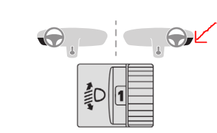

Hi,
any one know how to raise and lower the dipped headlight beam?
Can’t find the mechanical roller shown in the hand book or anything in the software operating system.

Depends on what options you have:
If you have the Full LED technology headlamps, then there is no manual adjustment as the system does this automatically.
If you have the Halogen or Xenon headlamps, then the switch is located as arrowed for Right Hand Drive, or the other image for LHD:
If your're n o sure what you have pop your VIN up and I'll tell you.
