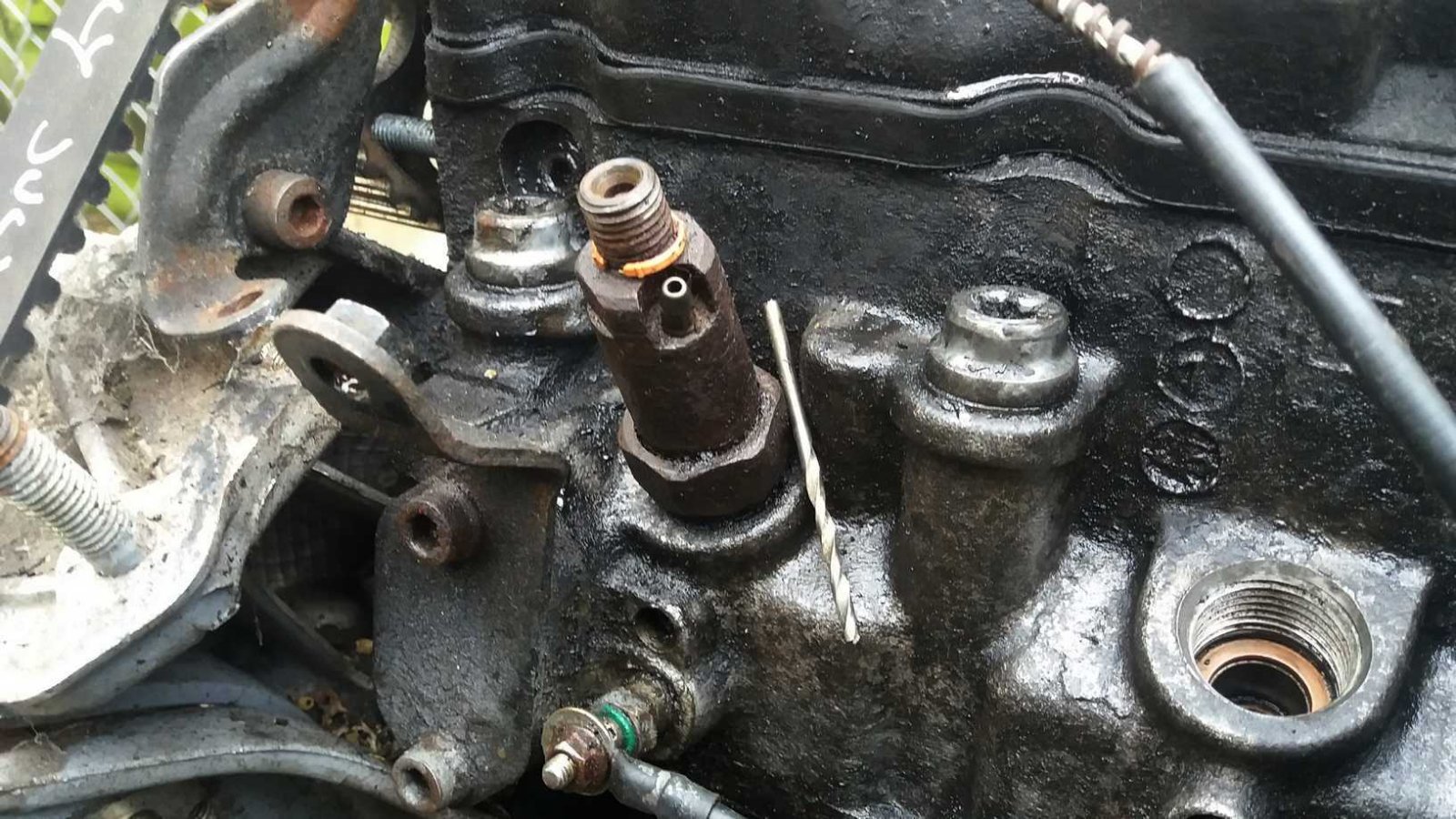

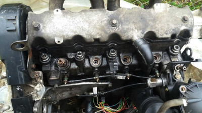

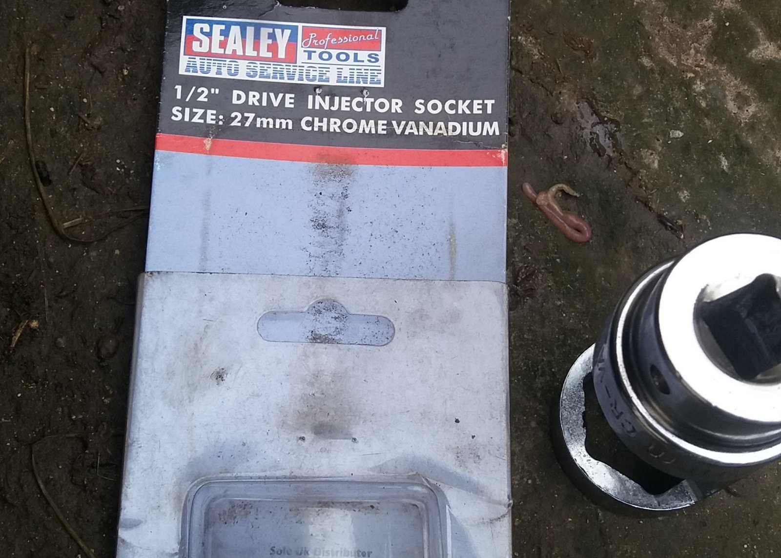

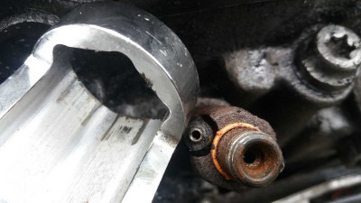

wee question...

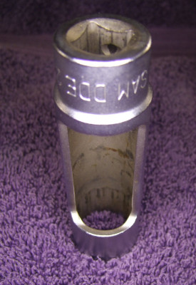

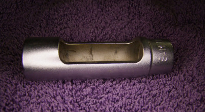

how on earth is one supposed to get Injector No. 4 out with this 'proper Injection Socket' when the space available between the Injector and the nearby protrusion on the Head
...is significantly narrower than the Injection Socket?
The 3mm Drill Bit demonstrates that clearance is a touch over 3mm, but the wall of the Injector Socket is approximately 6mm; which obviously doesn't work.

You need a slimmer injector socket.
The one I have here (chrome vanadium) is 3mm max wall thickness, 1.5mm minimum (where your drill is sitting).

That's a bit daft isn't it, that there's at least two thicknesses of the same thing. Oh well.

Clearly all Injector Sockets are not equal then Chris. Thank You. That's one for my Christmas List I think.

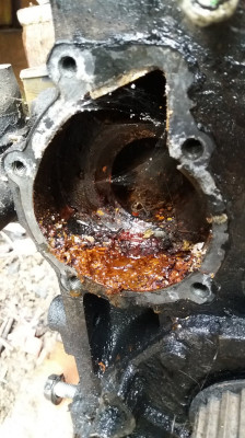

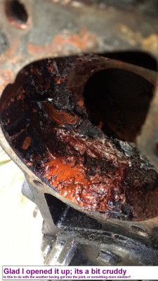

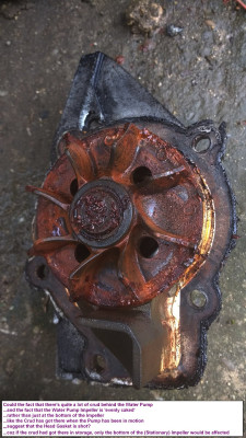

A slight new development, which could mean big changes
I couldn't help thinking to myself 'it'd be foolhardy not to have the Waterpump off' to see how it is behind there...
...so I successfully made a Gasket, as previously posted
...and having removed the Pump, found this
I'm thinking that this crudiness rather suggests that all was not well with the cooling system on this lump when it was last run, also see text on the pics
....and that at the very least, it was long overdue a Coolant Change, which isn't good either (I removed it from a scrapper in April 2016, so last start-up is however long it was stood prior to that)
If I need to have the Head off, there's no longer any point me using this un-tested bottom end at all, I might just as well use the other one which I had running before I removed it in Oct 2016 (I actually bought it for its recently re-con'd Fuel Pump, which it ended up I didn't need).
Mileage on the 'project' Lump is probably the odo reading on the car of 199k, while the ZX engine mileage is not known; it having the early type Dipstick, but later covers; therefore its clearly not original to a 1994 'M' plate car. It had 275k on the clock, which is the same as it happens, as the current mileage on my 405. (VINs available in both cases)
I had been thinking of preparing to start it / at least turn it over on the Starter, coz I think possibly I detected a lack of compression at one point, turning it on a spanner; that'd be a dead give-away. I suppose I could 'press on' for now and see what it turns like, but.... Hmmm

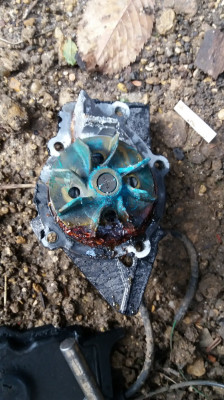

For comparison....
...this is the Waterpump and Housing on the ZX. The HG was very much shot, that's Coolant in the Milk Bottles!

You have to wonder what more might be in other parts of that cooling system, and the head.
Looks like a mixture of rust, calc and maybe a leak-stop.
As you say, badly neglected coolant.

Thanks Guys, that Waterpump pic that Chris copied is of t'other ZX engine by the way; the relevant one is nearer the top of the Thread; also a bit grim, but in a slightly different way.

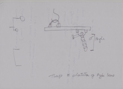

Any thoughts on this 'Spreader Bar' sketch, utilising Angle Iron and Exhaust Clamps; anyone made something similar?
Hoist is at top of the page, Gearbox on the right
Moving on though.... (I'm doing the Ostrich 'Head in the Sand' thing with the potentially shot HG until I've got it turning on the starter, coz sometimes you've gotta just keep your Momentum)

Ouch, not having it so easy yourself are you Puxa? My thoughts on this whole thing are, what are you looking to achieve with this exercise? If you're looking to prolong the reliable life of the vehicle then I'd probably go with refreshing the 275k ZX engine out of the car if you have somewhere dry to do the work.
I'd go with your header tank with the original lump for now, it'll run for a good while with the HG weeping anyway if not overheated so I'd use the angle iron to make a cradle for the ZX engine instead of the spreader (I managed single handed on the Black Xantia just going carefully and pushing the gearbox nose down to clear the "chassis" leg) then with a solid base to work from I'd do the head gasket and all seals with it on this "stand" so I have a freshly redone engine known good ready to drop straight in.
Do please replace the water pump though, I thought I'd "get away" with a decent looking used pump and it came back to bite me in the rear. Thing is, when they sit the seal sticks to the shaft and then tears, plus bearings can corrode and fail in short order after being put back to work. Here's hoping for better weather so we can get out there and do the considerable work we've got on our plate at the moment!

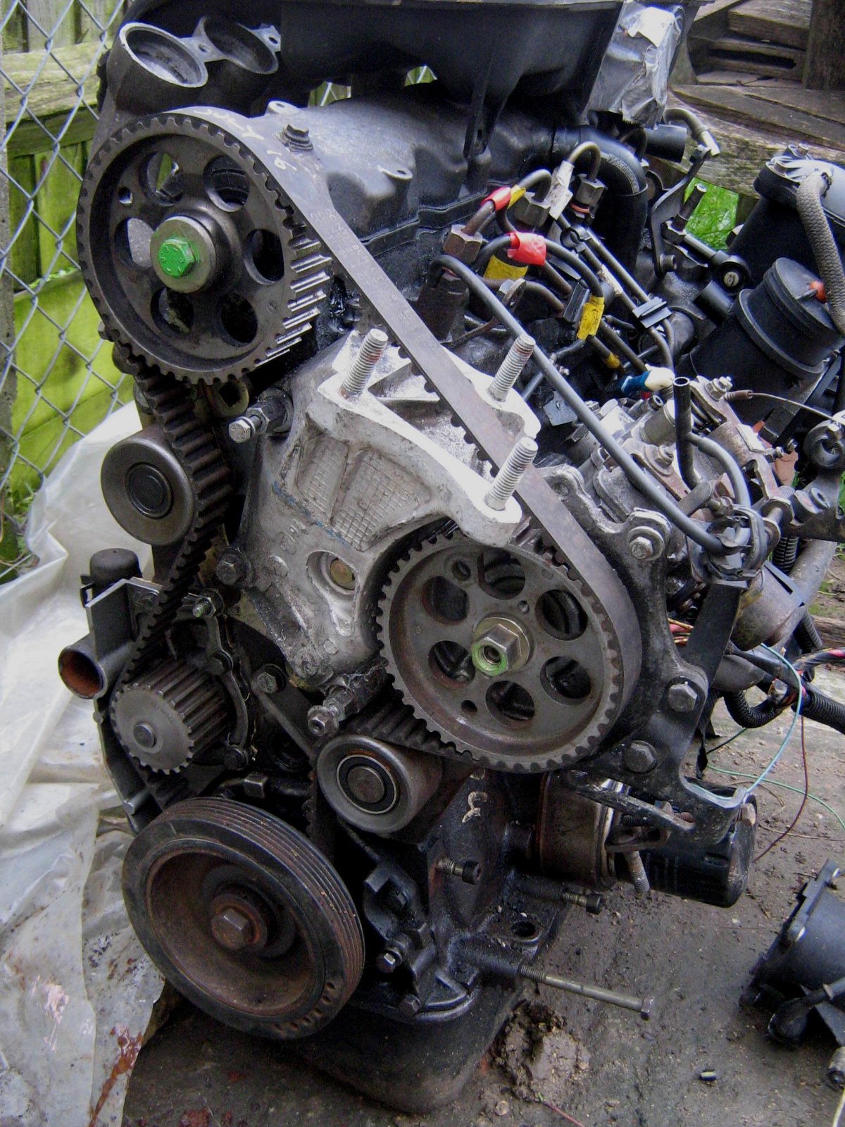

The Clutch is on, the Engine and Box are mated, the Starter Motors and Battery Cables are on and its looking good.
Am going to use the Engine Hoist to support it just take the weight and sit it on an old motorcycle tyre I acquired, rather than make a Cradle. That should be the next photo, in maybe a weeks time ish
