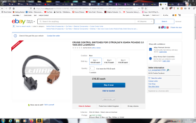

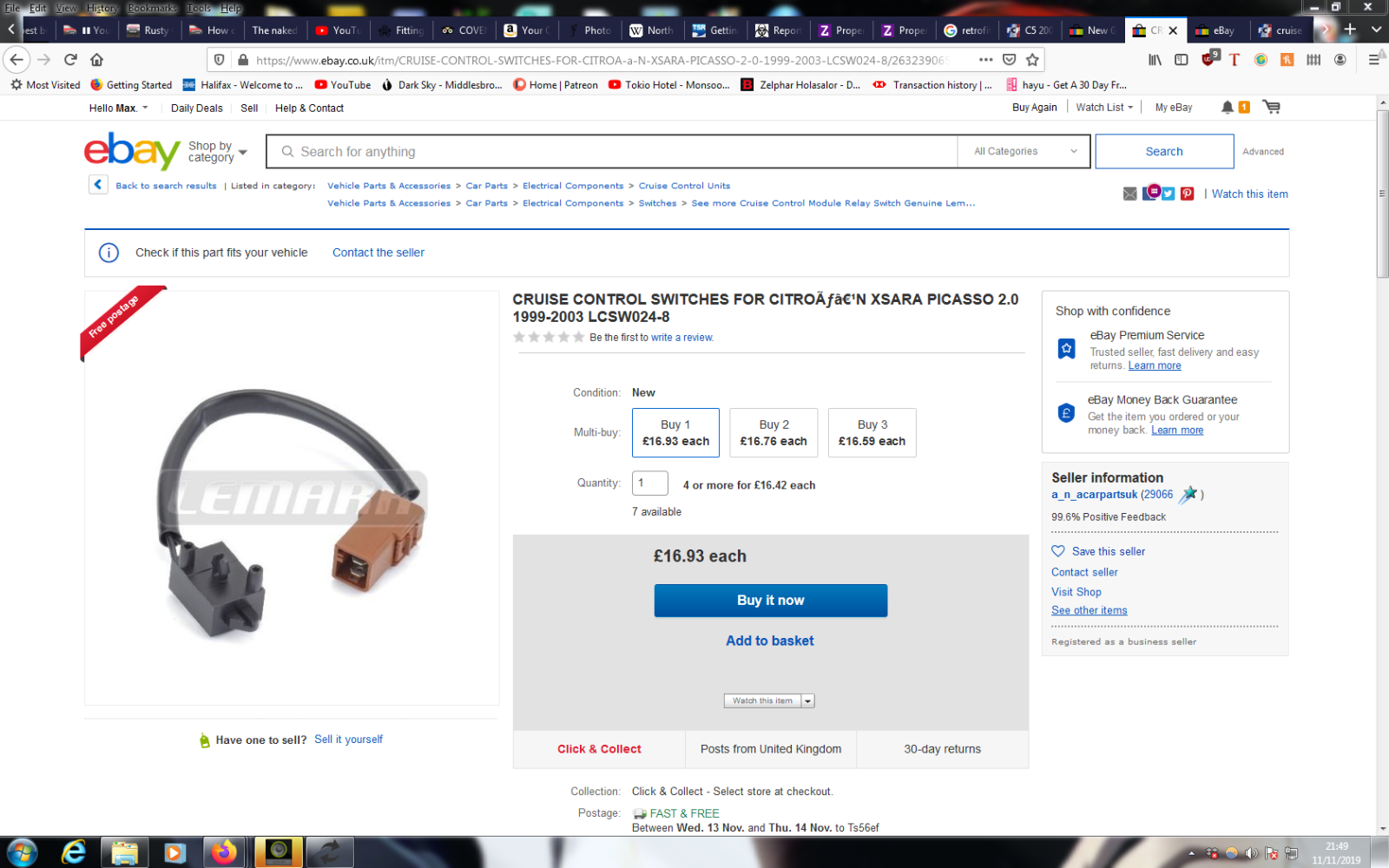

So is this something i will need to get it to work?
there seems to be a lot of these for sale on ebay at the moment

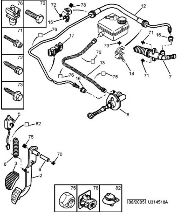

You already have this!
Item (5) below, clutch switch
