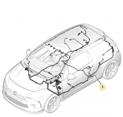

Ok, like I said they did not fit these to the DS3 until RPO 13749 (build date 1 July 2014). Your RPO is 13354 which is 1 June 2013 - an earlier model.
The intermediate electrical wiring harness shown below is one of many (there are over 25 versions of this harness alone) - but you do not have the correct one to support a camera basically.
Your existing electrical harness is part: 1609700780.
So my advice to you is get an aftermarket camera and a separate LCD screen that is built into a rear view mirror and mount this in place of your existing one.
One member did this on his C5 (X7) and it looked quite tidy. Some images are missing now as he used a hosting site instead of uploading them directly, but this should give you an idea. It can look ok without looking 'aftermarket'.
https://www.frenchcarforum.co.uk/forum/ ... hp?t=52248
The later harnesses were for different equipment options that affect the electrochrome mirrors, the type of parking assistance, revering lighting, windscreen sensors and collision detection stuff.- CONVERTABLE 3-DOOR SALOON AND SEQUENTIAL DRIVER’S ELECTRIC WINDOW AND STD ELEC CONTROL FRONT PASSENGER ELECTRIC WINDOW AND ELECTROCHROMATIC DAY-NIGHT INTERIOR MIRROR SINCE RPO 13293 EXCEPT WITH 2 REVERSING LAMPS
