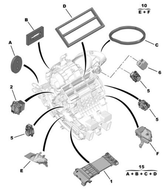

I've checked the details and you have the simple air conditioning system. According to the parts your vehicle doesn't have a separate Blower Control Module - the part is not shown as available. On the diagram your car shows as only having parts A-F. The Blower Control Motor is item (2) and that appears only to be for the digital climate systems. So I'm not sure what else I can do - The part is 6441AF. So before you do anything - I suggest you contact your dealer and clarify if this part is fitted on your system. They'll ask for your VIN. Better to be certain than purchasing one unnecessarily.
It could be that the control for your vehicle is fitted inside the heater control panel in the car in which case it could be a replacement panel - but again i suggest you check with them first.

At the risk of creating more work for Marc, a schematic diagram should give a better idea of how the motor speed is controlled.

It's not that simple Mike - I already checked and all it states if (where separate for both the control module and the blower motor), so clear as mud.
This is the location - but to repeat, parts filtered to VIN show as not fitted.

My point is that the wiring schematic will show whether there are power and control wires going to the motor (indicating that the controller is in the motor) or just power wires, indicating that the controller is in whatever block is upstream. It would probably also be useful to check the presence of supply voltage at the motor assembly.

This is what I mean:
8045: Blower Control Motor (if separate)
8050: Blower Motor (if separate)
Unfortunately the 3 digit wiring codes are 'unknown', so I can't tell you what they relate to. This is the C4 / DS4 with Single A/C and manual control with mechanically cable operated vents / mixing.
The full digital system is a lot more involved but shows similar wiring on the Blower Motor Control Module, with the exception of wired on Pins 5 & 4 being differently coded.
So why, if these both use the same Blower Control Motor is it not shown as a part on the parts system I don't know.
