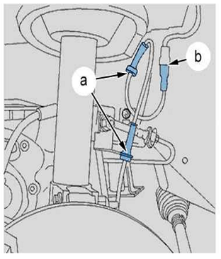

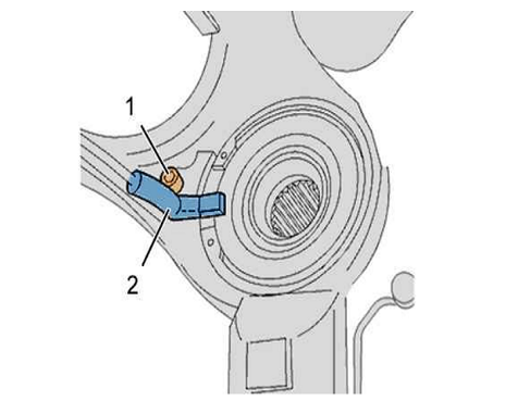

Nothing special - it is probably just 'stuck' in place with deposits over time. Assuming you are replacing the sensor, and not reusing it, a light knock should free it - but not if re-using.richarda wrote: 16 Oct 2019, 12:39 So is there a procedure to get it out? (some special wiggle?)
Or do I need to dismantle the suspension?
Thanks in advance
Any advice much appreciated.
Richard
| Disconnect the connector (at "b"). Unclip the wheel sensor harness (at "a"). | Remove:
ESSENTIAL: Avoid knocking the head of the sensor.
Check the cleanliness of the wheel sensor (2).
Refit the wheel sensor (2).
Tighten the bolt (1) to 0,8 ± 0,1 daN.m.
Connect the connector (at "b").
Clip the wheel sensor harness (at "a").
Refit:
- The splash shield
- The wheel
- The wheel bolts
Road Test and read any fault codes.

Unplug the ABS sensor and free the cable

Remove the ABS sensor
