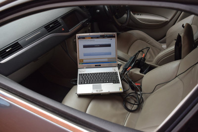

The suspension can be depressurised on each axle, if you don't have access to diagbox - otherwise it is in the repair menu and is simple to do.
What you must do is disconnect the battery - or the pump may operate if any of the doors are opened and of course will start trying to pump LDS out everywhere.

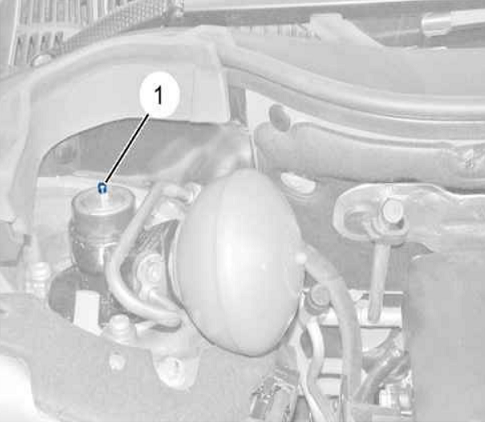

No - you need to depressurise the axle (front axle for a front strut) before you take off any pipes if you are not using Diagbox to depressurise the whole system for you, or you will have LDS spraying all over the place.
Manual method of depressurising the front axle:
Disconnect the battery.
Raise the vehicle and support on axle stands, wheels free.
This will cause a fair bit of fluid to come out I suspect.
- Place a hose on the pressure release screw (1).
- Gradually unscrew the pressure release screw (1).
- Wait for the pressure in the hydraulic circuit to fall fully.

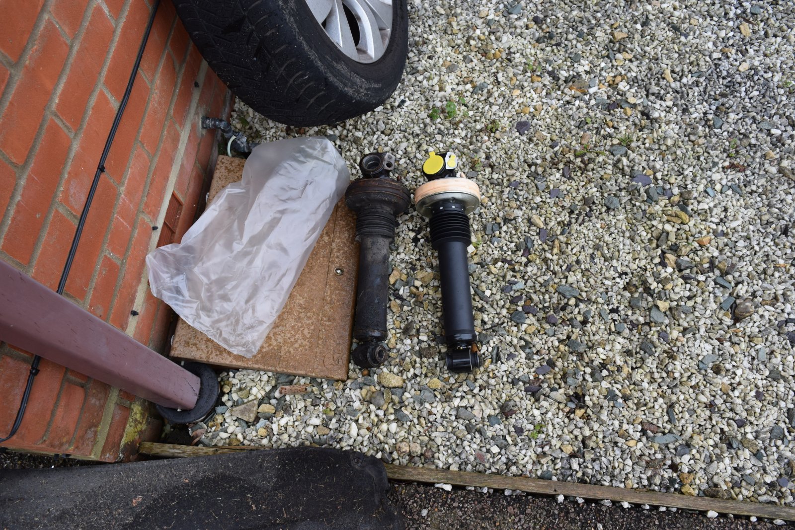

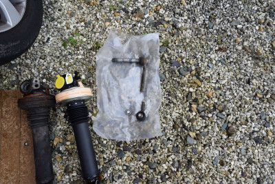

Sounds like you have a sensible driving style to me Marc. On another note-Success!! managed to change the suspension strut last weekend and so far so good. Only issue was the bottom drop link stripped its inner holding thread so i had to chop it off with an angle grinder. Had a result with the local citroen dealer, they said that as the car was over 3 years old they have a list of recommended pattern parts so bought a pair of drop links for £28.
i followed the above video and did not need to remove the hub tho I think I am keeping machine mart going single handed as i bought one along with a 1 metre long breaker bar just in case!
I took photos as a guide but struggling to post them using the above link in the toolbar

Don’t use the image tag, just use the full editor, then at the bottom choose attachments tab, then you can browse images in your device and upload them. Then once they are uploaded, just insert at the cursor position using the ‘place inline’ button next to the uploaded image list.

Hello!GiveMeABreak wrote: 26 Oct 2019, 17:52 No - you need to depressurise the axle (front axle for a front strut) before you take off any pipes if you are not using Diagbox to depressurise the whole system for you, or you will have LDS spraying all over the place.
Don't use recovered LDS fluid - it is hygroscopic. Always replace with new fluid and keep the container sealed until needed.

You can't undertake this operation with the suspension system pressurised!
Ideally the vehicle needs to be done where it can be supported and raised on the relevant corner in order to remove everything - but before you can do that the suspension circuit must be de-pressurised in order to remove the suspension sphere.
