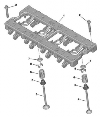

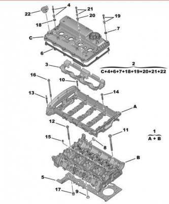

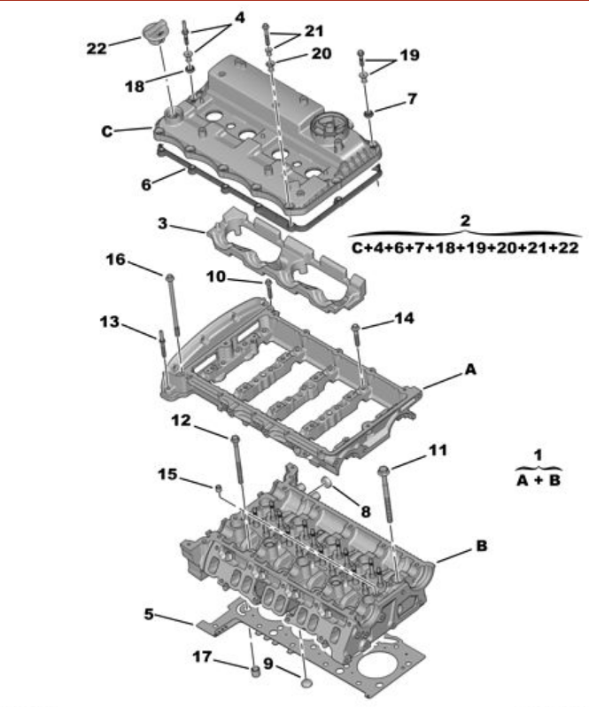

I thought this was going to be an easy one seeing as you identified the area and pointed to the suspect part - turns out that 9808676280 is the engine! :shock:
So the most obvious thing that site on top there is the cylinder head / rocker valves......

Give it a little while - so others can check out the video and add their comments. I'm more on the technical / electrical side, but I'll point my colleague to your post to get his opinion. I just put up those diagrams so you could get a better idea of what's underneath that area and I'm not suggesting it is the rockers, so don't want you to get stressed. :wink:
