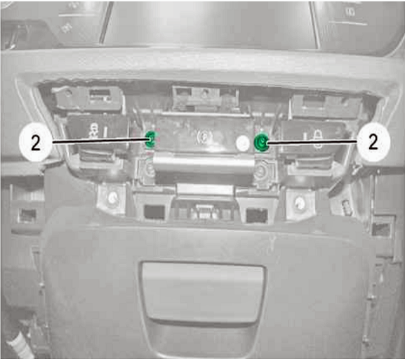

Maybe you have radio removal manual? Iknow it sits behind 7' lcd screen. It would be great to know how to remove it without breaking hidden screws.
- x 6956
Re: C4GP radio wiring
It's done in several stages - you'll need to remove the central vent then the display...
First, you must disconnect the battery - if you do not you can brick your Audio / display when disconnecting / reconnecting power!
Use this procedure and again when reconnecting later on:
BSI Reset / Battery Disconnect / Reconnect Procedure
Removing Central Vent
Dismantling the Touch Screen
Removing Radio Unit
Refit in reverse order and ensure you follow the section to reconnect the battery in the link above.

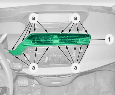

| Unclip the central air vent (1) (at "a") using trim removal tools. Detach the central air vent (1). | Disconnect the connector (at "b"). Remove the central air vent (1). |

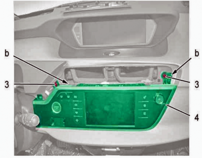

| Unclip the trim (1) (at "a") using trim removal tools. Remove the trim (1). | Remove the bolts (2). |

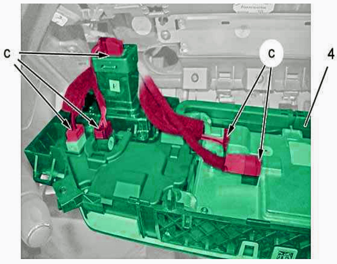

| N.B.:Unlock the steering column, pull fully and lower it. Remove the bolts (3). Unclip the touch control panel (4) (at "b") using trim tools. Detach the touch control panel (4). | Disconnect the connectors (at "c"). Remove the touch control panel (4). |
Remove:
Remove the START/STOP button (5). |

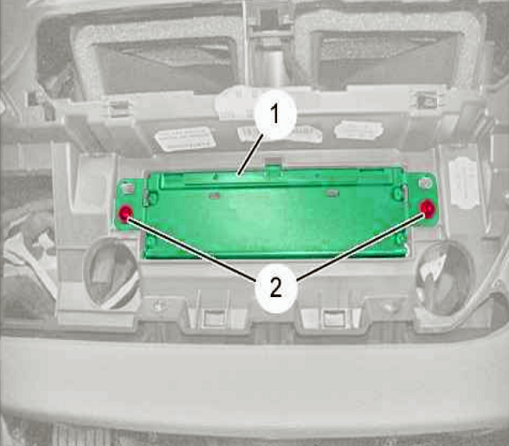

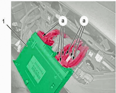

| Remove the bolts (2). Remove the radio (1) from its location. | Disconnect the connectors ( as "a") (According to equipment). Remove the audio system 1. |
