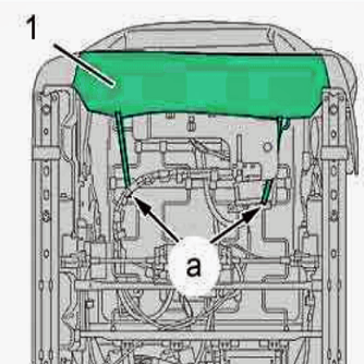

The seats need to come out - all the underside clips and trim have to be removed.... I've put the stripping procedure here - just use what you need to do the job - but be mindful of the airbags - disconnect the battery and allow 15 minutes for the Airbag ECU to discharge before starting work on them.
Remove the front seat.
Disengage the elastic holders , as "a".
Release the lower trim ( 1).
