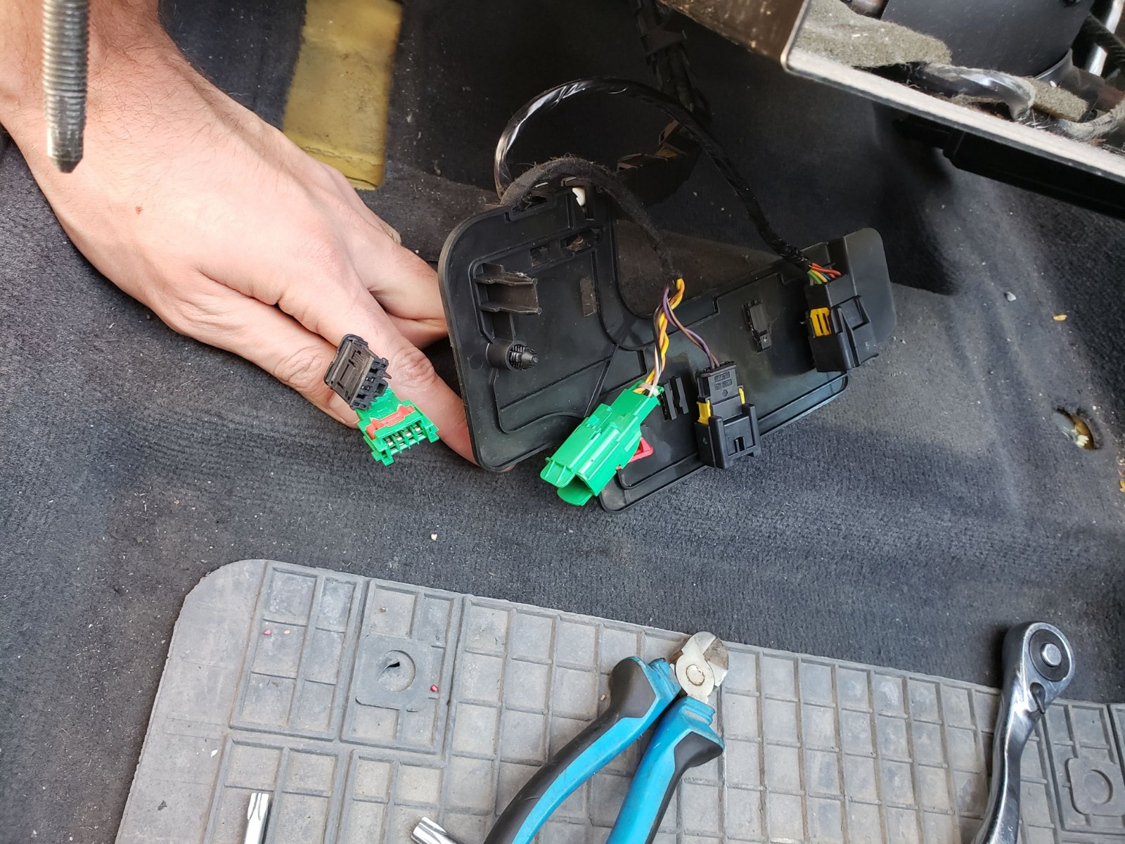

So after almost a year I finally decided to do it as the driver's seat started giving me lower back pain. I just went to a junkyard where I found a car with mint seats all working and leather was in good condition. I took off the passenger seat on both that car and mine just to see that my car only has two little wiring harnesses coming from the carpet
(the ones I'm holding on the picture)
and the car with electric seats has a lot more wires in the loom. Some of the plugs were completely different from mines and the electric seat has some sockets where I don't have wires to plug into. So is there anything else I can do or I am screwed to only have manual cloth seats?

x 6945
Re: C5 Seat Upgrade
MK I and MK II (or facelift) are completely different and have different wiring harnesses. I am assuming you have a MK II form your profile. Secondly, the harnesses changed during the build run so will be different. Post your VIN and I'll see what you have originally against what you need.

Re: C5 Seat Upgrade
Unread post by Stickyfinger »
In my experience the simple method is just swap the air bags in the side of the seat (easy to do) ....then you have the correct plugs.

The VIN of the car is VF7**************[VIN obfuscated, can be read by forum staff]
x 6945
Re: C5 Seat Upgrade
Do you have the VIN of the donor car? And was the donor car a MK I or MK II?
Your wiring harness for for your MK II Estate is 6509K7 Your build date is 10207 (19 October 2004) and the wiring harnesses changed from build code 10556 (3 October 2005). The intermediate wiring harnesses are also different for Saloon and Estate versions as well as the build dates mentioned before.

Unread post by Rosian Drashkov »
I dont have the VIN of the car I was looking at but it was a MK I from 2004 so I thought since it was the same year as mine it would work. But what I'm wondering is do I have all the wires needed to power the electrics and the heater as I showed in the picture I only have two plugs and the seat has three sockets so one stays open all the time. By the way I checked and I already have the 80amp maxi fuse in the fusebox under the bonnet.
x 6945
Re: C5 Seat Upgrade
Although the seats are mostly the same between MK I and MK II, the wiring harnesses changed and again on the build numbers and again between saloons and estates. So I can't help you with those - but I suspect you may not have the connections for the heated seats.

DIG DEEP into the carpet.....mine were very well tucked away and covered in foam.
