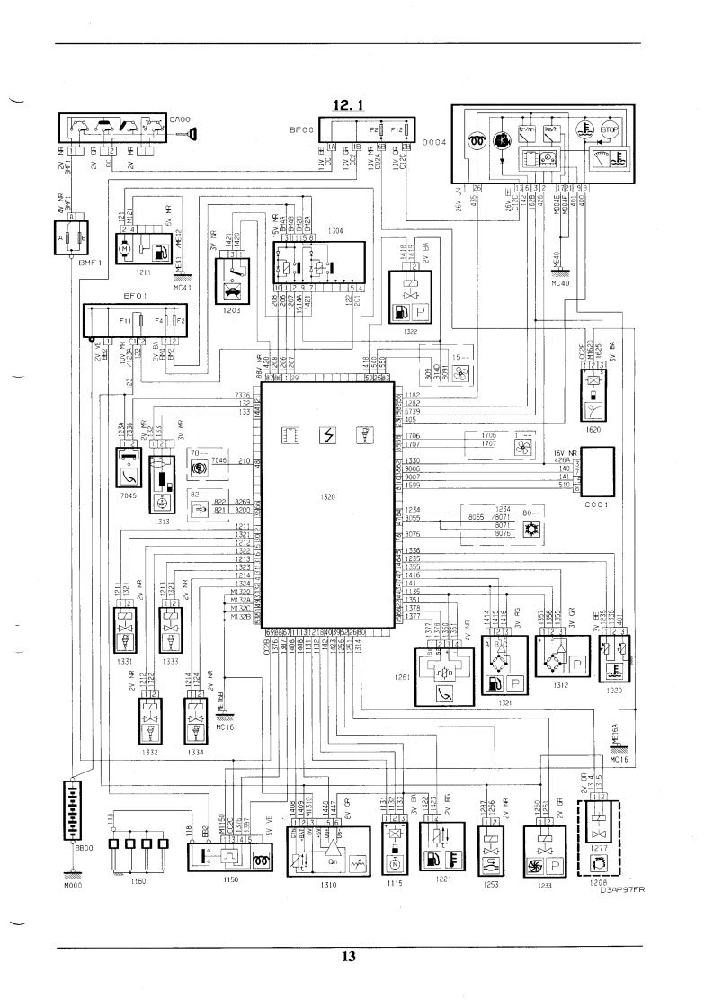

Herewith the Engine ECU diagram.
It also shows the coolant temp sensor #1220, which (as Mike says) feeds both ECU and Gauge from its two outputs.
