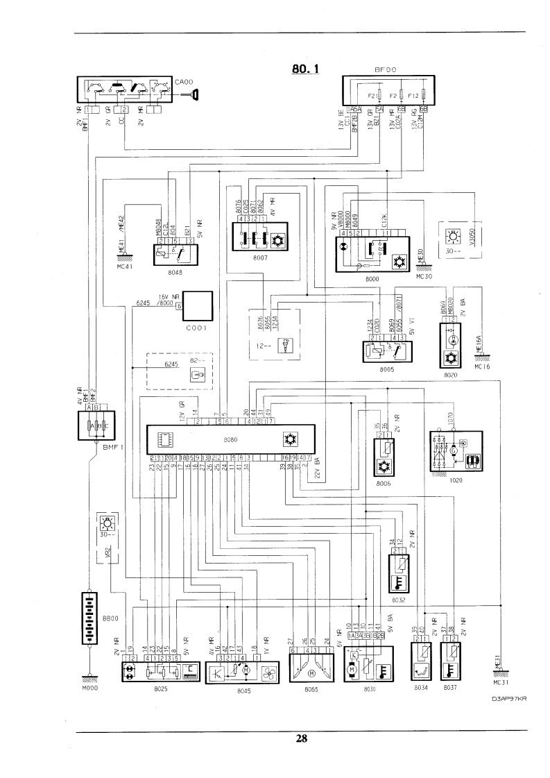

Re: Xantia A/C
I hope that Chris can post up the correct schematics for your fans and A/C. The fans should both run at low speed, so you have an issue with those to sort, maybe a seized fan or corroded relay socket.
Do the other heater controls (temperature control flaps, blower speed) seem to work correctly?

Re: Xantia A/C
A/C wiring diagrams for the car
Xantia 2.0 HDi 90 BVM5 DW10 TD RP=8346
click to enlarge
Hope helpful.
click to enlarge
Hope helpful.

Re: Xantia A/C
As the problem looks to be the cooling fans, the diagrams for those are as follows.
Looks to be the classic arrangement of 2 fans plus relays for the DW10...
As Kenny says, with IGN on, unplugging the Brown sensor usually brings fans on at full speed.
Turn them off by re-connecting the sensor, then turning IGN off then on.
Turning on AC should bring fans on at slow speed.

- white exec
Re: Xantia A/C
In the circuit diag above (2 fans, 3 relays, and control by the engine ECU), the temp sensor is #1220. Three-way connector, but only two wires connected into the fan circuit. If BE means 'bleu', then it is indeed blue . . . not the traditional brown.
Can't see any other temp sensing shown. Relays appear to be standard 5-pin 12v 30/40A changeover type, so easily renewed if necessary.
It removing and playing around with the original relays, it's important to get one of them (#1504) in the correct slot, as it is the changeover one. The other two are just makes. If you fit new relays, just use 5-pin changeover for all three, so positioning is immaterial.
Arrangement is classic series (slow speed) parallel (fast speed), and no electronic speed control or dropper resistor, so, as you say, both fans need to be in working order for Slow to operate.
If one is dud and open-circuit, only the good fan will run on Fast; nothing will run on Slow.
If one is dud and shorted/seized, on Fast it will blow its fuse. On Slow, just the working fan will run, Fast.
Both fans should, as you say, always operate at the same speed, and together.
