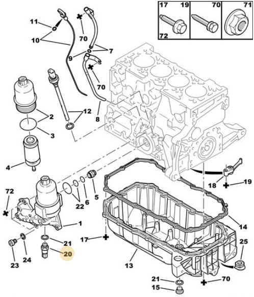

I find that parts exploded views can be really helpfull in identifying stuff......is the oil filter below the unit?? and does the oil pressure light work on the dash.
- x 6955
Re: What is the function of this sensor?
This is a Xsara II Petrol 1.6i 16V TU5JP4 with manual 5 speed.
The oil pressure switch is item 20.

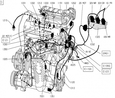

Here is the location in detail of the sensors:
As you can see both the water temperature sensor and the oil temp. sensor are in close proximity and would seem to share the same warning trigger wire (405).

I think that there is an error in the information above, and 4025 is actually a coolant sensor. The diagram above does not show it with the correct yellow connector, and the symbol shows water rather than oil. It would also seem unusual to locate an oil temperature sensor so far from a body of oil.
If the car was not originally intended to use a sensor that is fitted to the standard engine, the sensor may not show up in the wiring diagrams for that car.
