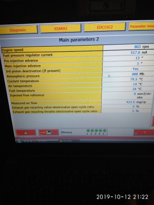

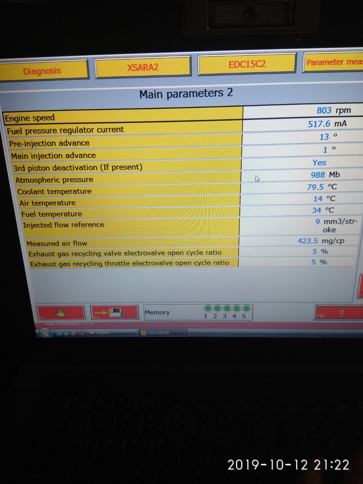

What does the main brake signal refer to in the driving information screen?
When I press the brake, the indication does not change from released. The exterior brake lights work fine.
Should pressing the brake switch change the 'Main Brake Signal' indication?
The info screen states that it is the 'information given by the vehicle brake pedal sensor'.
The redundant brake signal is used for the cruise control.
The clutch indication works fine.
Injected flow ref is 9mm3/stroke. Ref States 5 - 7 mm3/stroke.
Accelerator pedal hard spot signal 2 is pressed. Ref States or should be released.
Difference between measured and ref fuel pressure -6 bar. Should be 0.
Injected fuel flow reference is 12mm3/stroke. Should be between 5 and 7.
After warming , injectors 1 and 2 are .0.59mm3/stroke and -0.43 respectively. 3 is 1.9 and 4 is 2.3.
Measured air flow is 441.1mg/cp. Should be between 200 - 290mg/cp.
Fuel pressure regulator current is 520mA. Should be between 600-630mA.
Pre injection advance is +13deg. Should be between -11 and -9.
Main injection advance is 1deg. Should be between 3 and 4.
3rd piston deactivation is yes. Should be no.
Injected flow ref is 10mm3/stroke. Should be between 5 and 7.
Exhaust gas recycling valve electrovalve open cycle ratio is 5% . should be between 70 - 95.
Exhaust gas recycling throttle electrovalve open cycle ratio is 5%. Should be between 64 and 70.
Sorry for the formatting, on phone in garage at the minute.

Re: Lexia install problem
See images attached:
Note the fuel pressure difference between actual and ref flickered to -2bar as I took the image. Should have been -6 bar as per the text.
About 15 minutes previously to the above values, I got these values. Note the injector correction values. I've no real idea what is going on.
I suspect that the MAF is goosed and until I get that fixed everything else can be corrupted, correct?
