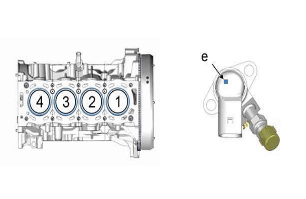

Some like yours, should just have the classification and this is all you need to code it: Classification 4, 5 or 6 as per the table below for the Siemens ECU. Other ECUs can be different and some require par of a code to be input, but no yours.
4Minimum
5Nominal
6Maximum
So the marking shown as 'e' should correspond to the table above - and you should just need to enter the single classification. But as said, it must correspond to the same classification as the existing ones. Mixing classification types will stuff the particle filter system.

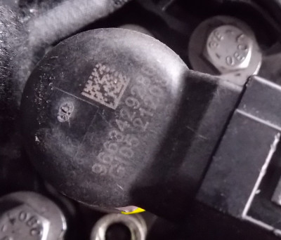

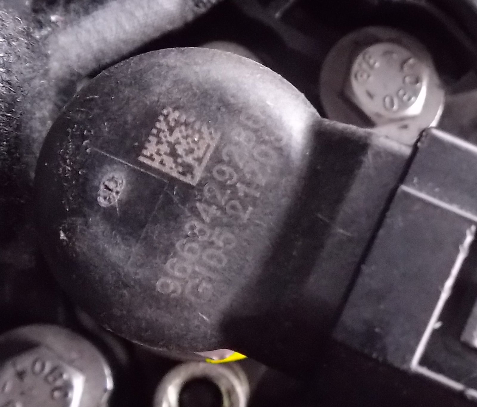

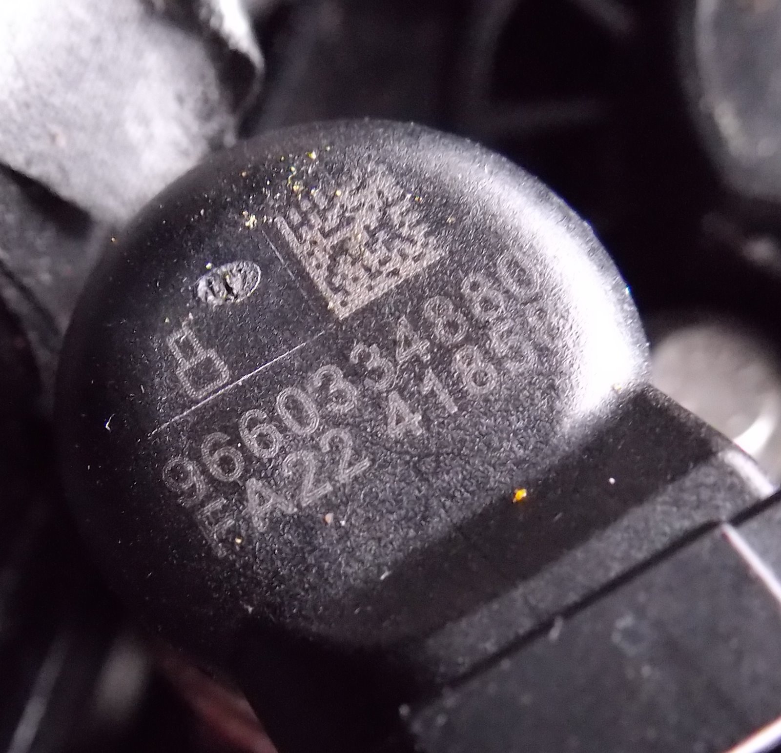

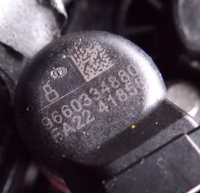

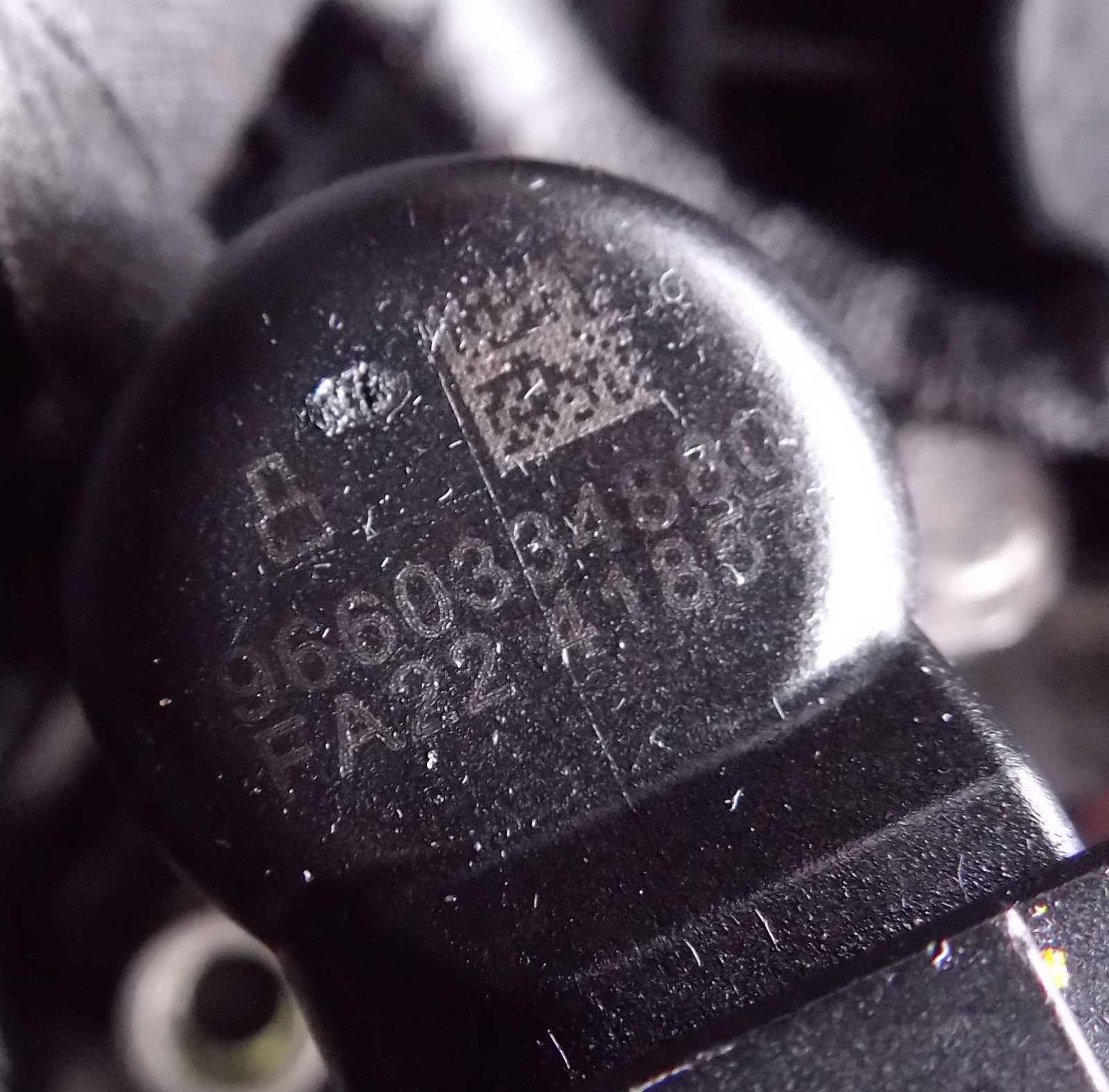

No joy with any of that, the new (recon) injector throws up all sorts of faults and puts the car into limp mode so for now I've put the original one back in.
It runs sweetly but still weeps slightly at the thread, I've fitted a new washer and tightened it as tight as I dare.
No fault codes showing on my scanner or on the dash.
Got a couple of photos, two of the originals and the recon one supplied, I checked and double checked with the supplier before buying and was assured it's correct and with a 12 month warranty
The originals with the FA prefix, the recon with G
x 6955
Re: Getting fed up!
Well from what I can see what he's sent you aint right! :roll:
Citroen part number indicates 1980J9, a class 7 injector and that matches up with the
9660334880 injector as shown on your originals from your picture.
