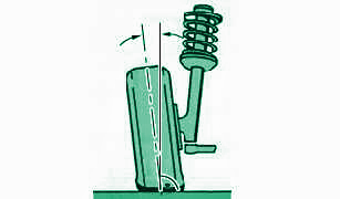

To start you off:
Geometry Angles
Geometry Angles
| Camber Angle: Angle formed by the plane of a wheel and the vertical (Vehicle seen from the front). | Castor Angle: Angle formed by the pivoting axis of the front wheel and the vertical (Vehicle seen from the side). |
| Kingpin Angle: Angle formed by the pivoting axis with the vertical, measured in the transverse plane of the vehicle (Vehicle seen from the front). | Tracking: Difference between distance A and distance B (Front of the vehicle: In the direction of the arrow). A less than B: Positive + or Toe-in. A Greater than B: Negative - or Toe Out or Opening. |
| Thrust Angle: Angle formed by the thrust axis of the rear axle and the longitudinal axis of the vehicle. |
