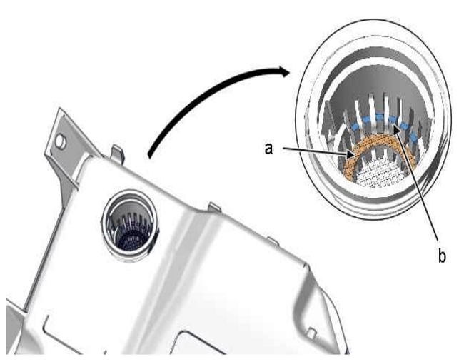

The cap pin hole is designed to release small amounts of pressure. You should check the fluid level on level ground on the lowest suspension setting though. The level should be between 'a' & 'b' - again with the suspension on the lowest setting and then switch the engine off.

I wouldn't to be honest, as the system is pressurised - and you don't want any LDS getting anywhere near the BHI / Pump if it is under slightly higher pressure. Just get it to flat ground, leave it to stabilise and then check levels as above.

.......and take a BIG syringe to empty the LDS tank down to its correct level....
They "suffer" from people thinking that they need to be "Full"
