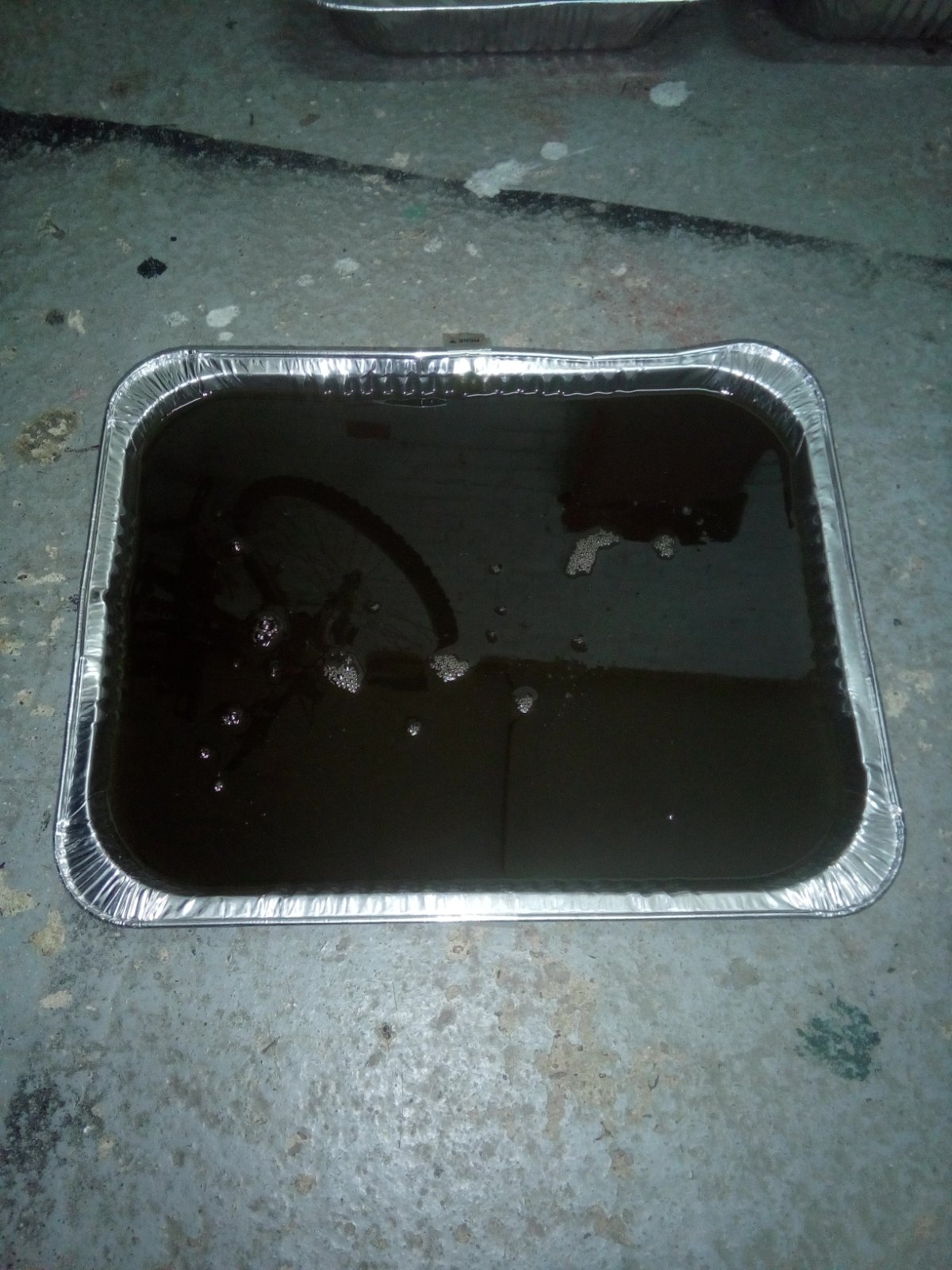

Clutch pedal removed, filter swapped, reinstalled pedal, drained gearbox, filled up with fresh oil until it gushed out the fill port..... Waiting for the gush to turn into a slow drip and replaced the fill port. New washer on the sump drain plug too. Car seems to run fine. Gears work fine. Downshifting is a lot smoother too! Blower is more powerful due to better flow. All seems well.
