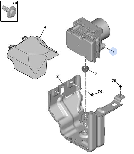

Ok, so the part number for the complete block and ECU is 4541Q1 or 4541Q2

This is for the complete module.
Have you actually had a diagnostic done? If so, what were he fault codes? I’m curious as to why you think the ABS block / ECU is at fault. These are not cheap, so essential to make sure this is indeed the fault. Your C4 doesn't have ESP, and it looks like this is a complete unit, so no separate ECU shown.
There should also be a label on the top of the ECU part of the ABS block with a long number. Can you confirm that it is (9663345480)? If so, searching on this number will bring up more choices of second hand suppliers when searching.
These are massively expensive when new, at £1,228 inc. VAT from Citroen, so I would really make sure you need to replace the unit and that it is not just a wheel sensor that is bad or a connection.

Hi Marc, had diagnostics done a few weeks ago. The car has gone into limp mode. It is coming up with abs light, engine management light, stop light, airbag light all on on the dash. No display on the cluster and seat belt safety pretension ear warning and depollution filter warning, which is odd as its a petrol not diesel. Took it to a French car specialist near me for diagnostics and came back with abs ecu module as the problem. Told me that I could probably pick the part up online and he would check it for me before fitting. Is it easy to to get to the number on top of the block?
- x 6945
Re: Citroen C4 vtr+
It should be visible from the top of the ECU, but needs the inner wing mud guard removing to get access to it.
