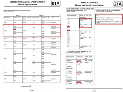

Hello,
I plan to change the transmission oil.
I was under the impression that I need 75W80 GL-5.
However, my PDF service manual suggests I use 75W80 GL-4.
See attachment, thank you.
MEGANE III 1.6 Petrol 2009 - BZ0H - K4M 848 - 5 Door Hatch.
- Posts: 42019
- x 6955
Re: What Transmission Fluid Do I Need?
Stick to what the manufacturer recommends:- GL5 has nearly twice as many EP additives as GL4. The EP (Extreme Pressure) additives serve to prevent micro welds on the gear flanges that can reach temps up to 800° C. The problem is that these additives do not react well to yellow metals like copper and bronze - i.e. the synchromesh rings in a gearbox - so you really want to stick with GL4 unless Renault specifically allow GL5 for your specific vehicle.

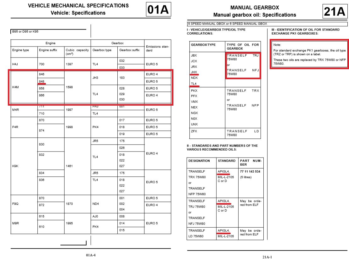

I'm confused which is the correct oil. ELF have 2 types of 75W80 GL4.
One called NFJ and the other is NFP.
They both state compatibility with the J and TL4 gearboxes.
However, the data sheet I attached suggests J and TL4 gearboxes require TRJ/NFJ oil. Not NFP!
NFJ:
https://catalog.elf.com/en/products/nq7 ... NFJ-75W-80
NFP:
https://catalog.elf.com/en/products/nq8 ... NFP-75W-80
NFJ appears to be semi-synth.
NFP seems to be for extreme usage and fuel eco friendly. Doesn't say if it is semi or fully synth.

I think you'll find the NFP is fully synthetic as it omits 'semi-synthetic' which contains minerals.
I would again stick to NFJ as this is what the technical sheet you have states. The NFP one does seem geared towards the 'highly stressed' use and is probably not needed unless you are racing your car all the time.

Total-Elf lists manual transmission oil NFJ 75W-80 for your K4M. Tech spec for this is GL4, so where this is specified, avoid using anything which is GL5 or GL4/5.
In PSA boxes, GL5 can compromise the action of the synchromesh, as well as the risk of issues with soft metals that Marc has mentioned.

No worries, but regardless, just stick to the recommended GL4 - the TRANSELF NFJ 75W-80 meets the international GL4 specification so is correct for your box. It's not so much the Semi or Fully Synthetic element you should be so concerned about, but the correct specification. GL4 would of been used at factory, so just replace with the same.
