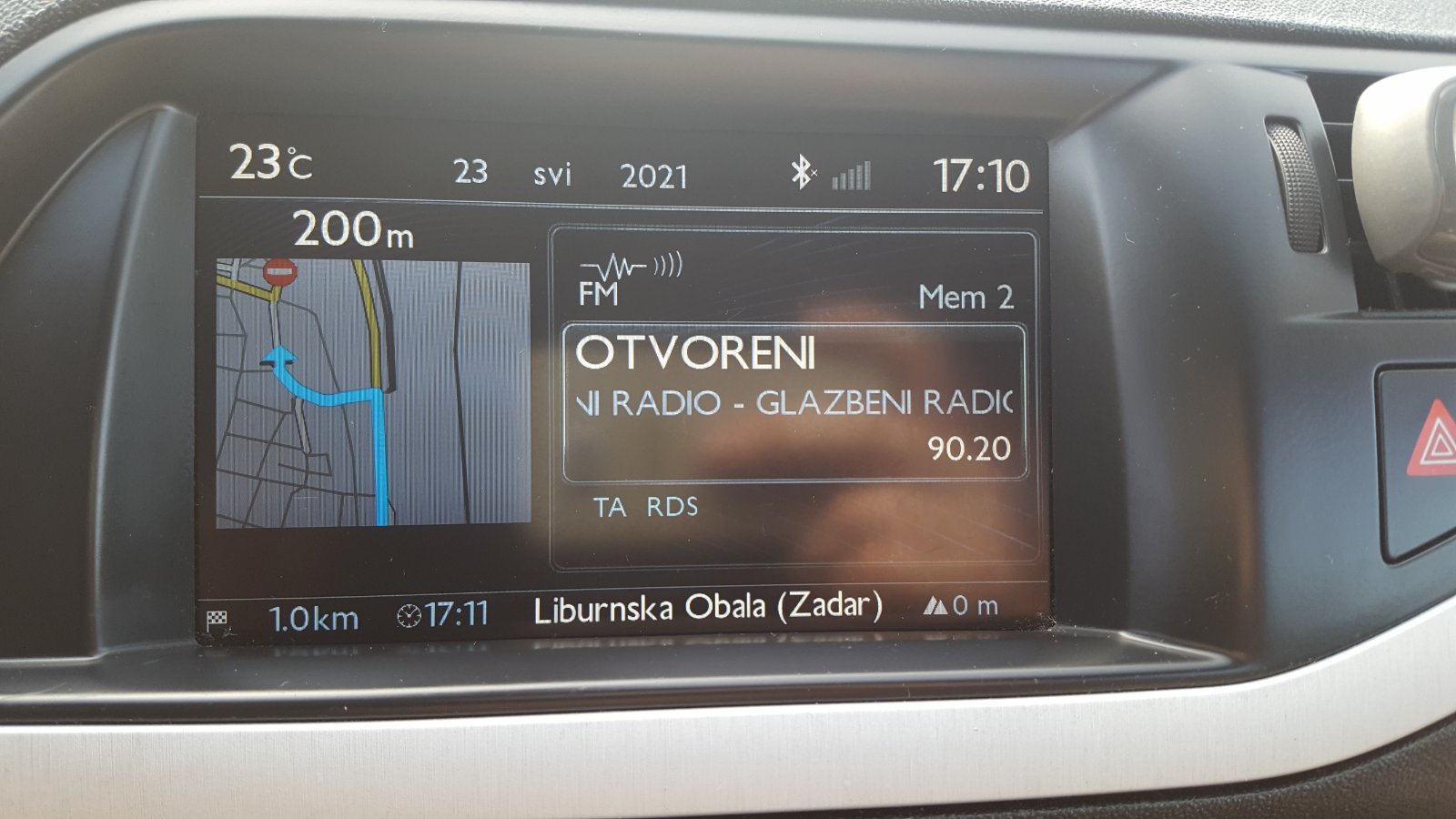

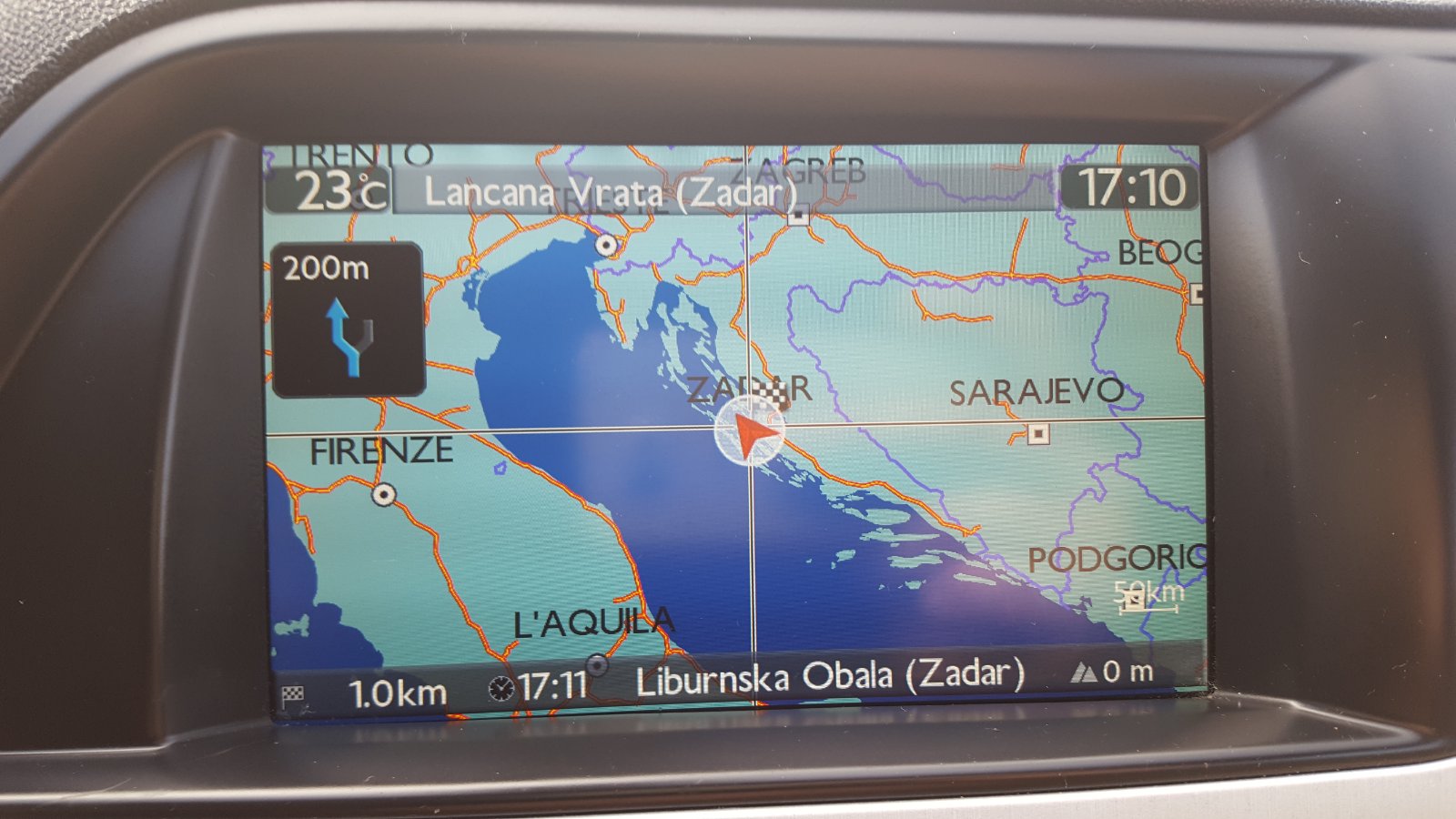

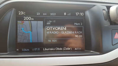

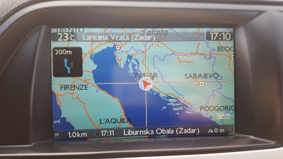

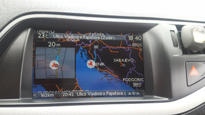

Hi i update maps on my c5 x7 to newest but can you tell me when i use navigation why os picture on screen always like picture on attachment. No streets and other things. Sistem is rt6 and software is rneg 2.80.e.2. Navigation show map of europe an that's it. How to solve this. Navigation is working good but on full screen show only that, with my position. Thanks.
- x 6957
Re: C5 X7 2-in-1 navigation tutorial
What system do you have? MyWay (RNEG), eMyWay (RT6) or Navidrive 3D?
It's stated above that "Sistem is rt6 and software is rneg 2.80.e.2."
Seems to me you're in Zoom mode. That's why you have that horizontal and vertical line with your position in the middle.
Use the central knob to get out of Zoom mode and revert back to normal map layout.
Unfortunatelly, I don't own a C% X7 or an RT6 to provide you a step-bu-step guide to theis...
- x 6957
Somehow I missed that!
It's called Map View. Just press the MODE button in succession to get back into full screen mode.

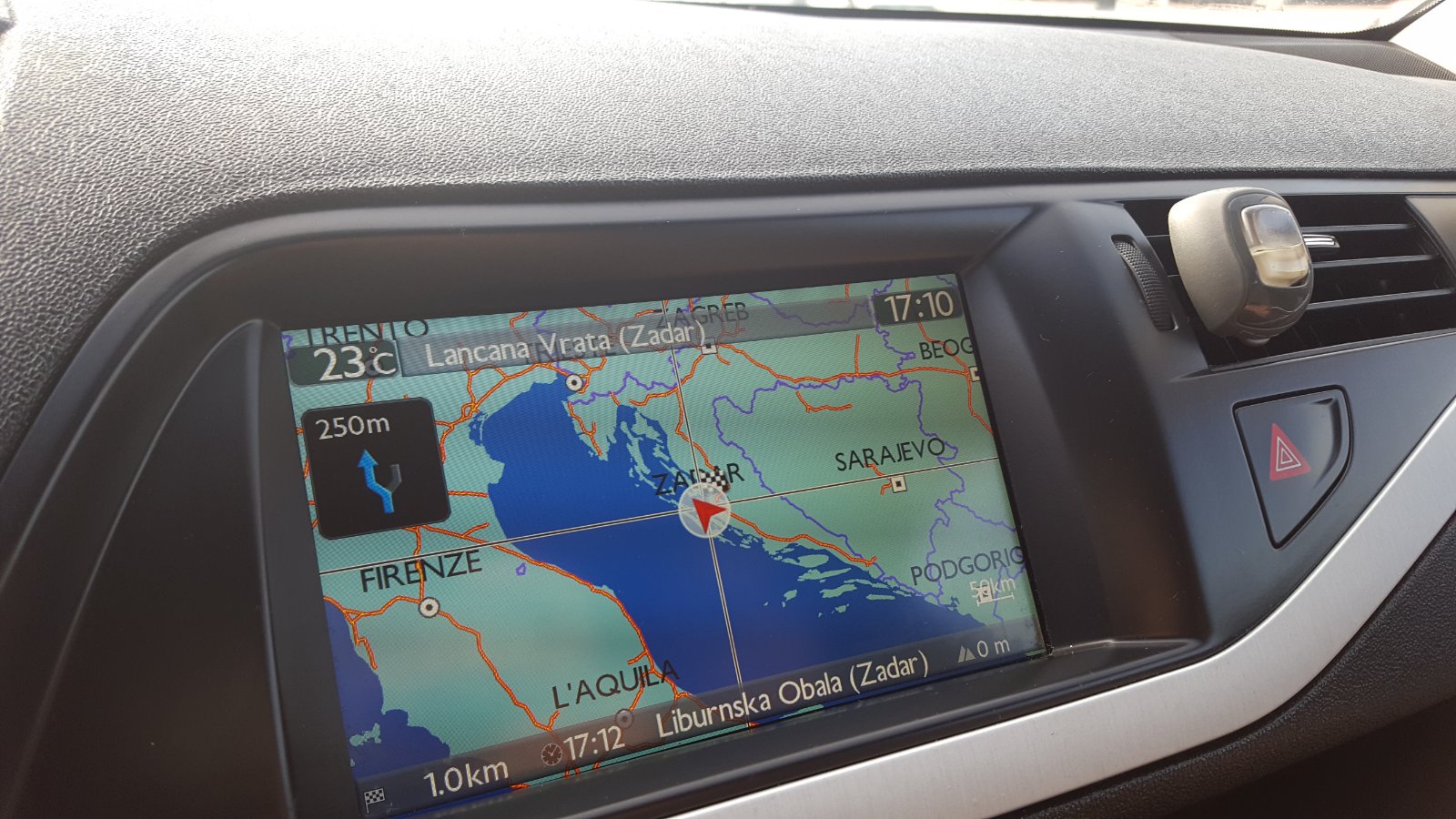

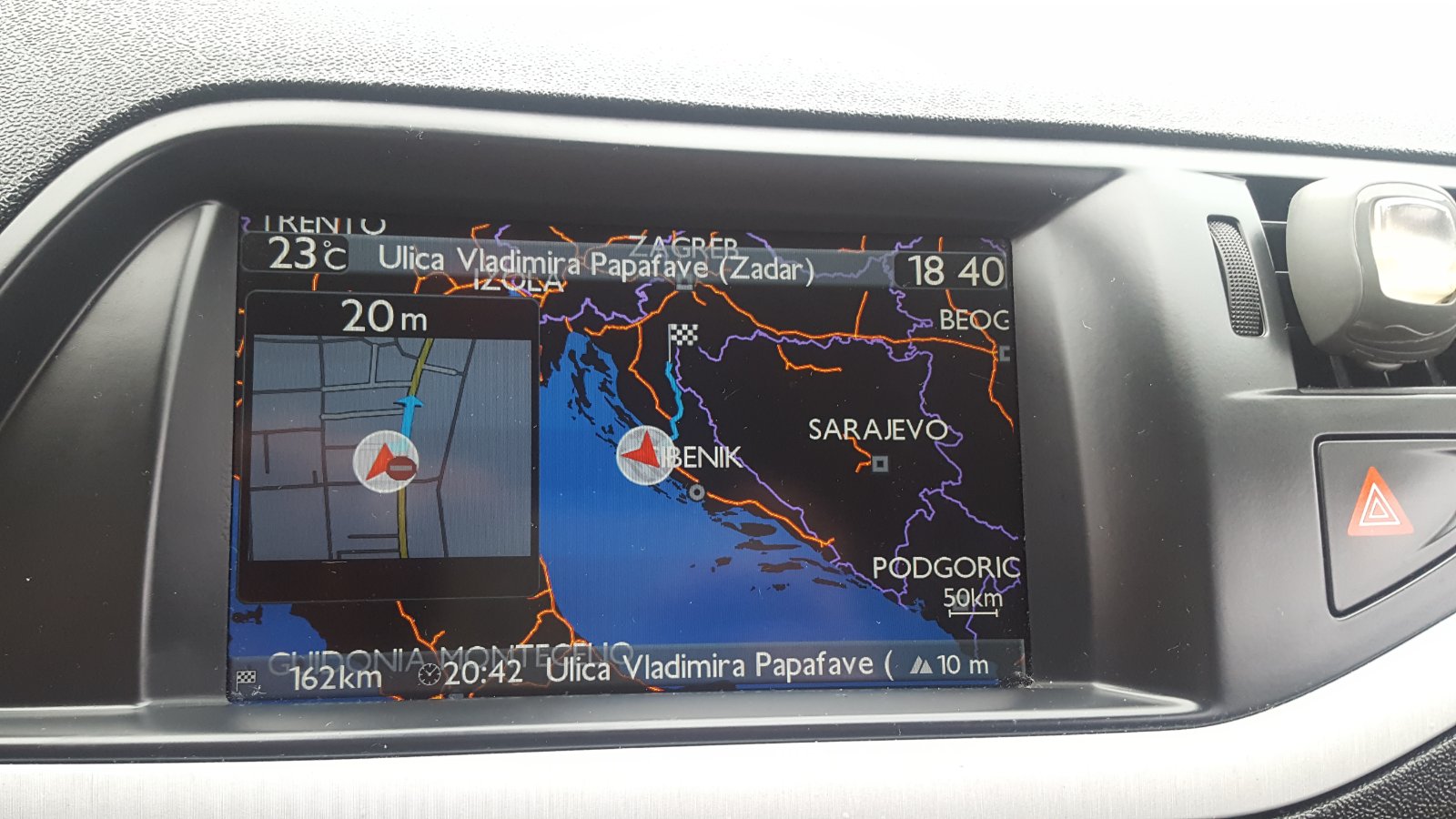

Need to try. but i think its not zoom mode. When i navigate sistem don't show that vertical and horizontal line and map is still on europe. Navigation seen on small window on top left corner.
Anytime you have the 'Cross Hairs' you are in 'Map Mode'. This is for moving vertically and horizontally across the map to get guidance to a specific location for example.
The other view (middle picture) is for split screen to show other functions whilst navigating, like the radio in your picture.
Do you have a manual for your car? If not I can provide you with one, let me know.
I solve the problem. Thanks man!
