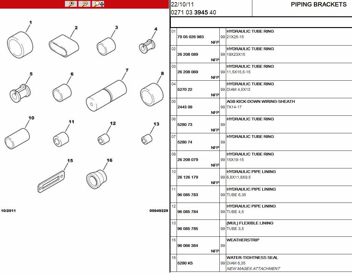

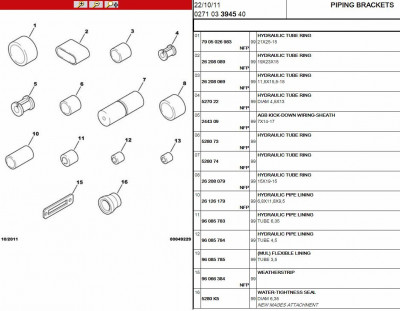

The rubber hydraulic seals for Citroen pipework are difficult to find on Parts.
Actually appear as "Pipe Brackets"...
- items #11, #12#, #13
Best to check with Citroen parts counter exactly which one for your brake caliper.
Annoyingly, not shown on the brake pipework parts diagram either.
IIRC, these seals are available separately (as well as in packs).
Special rubber. Cheap enough.
