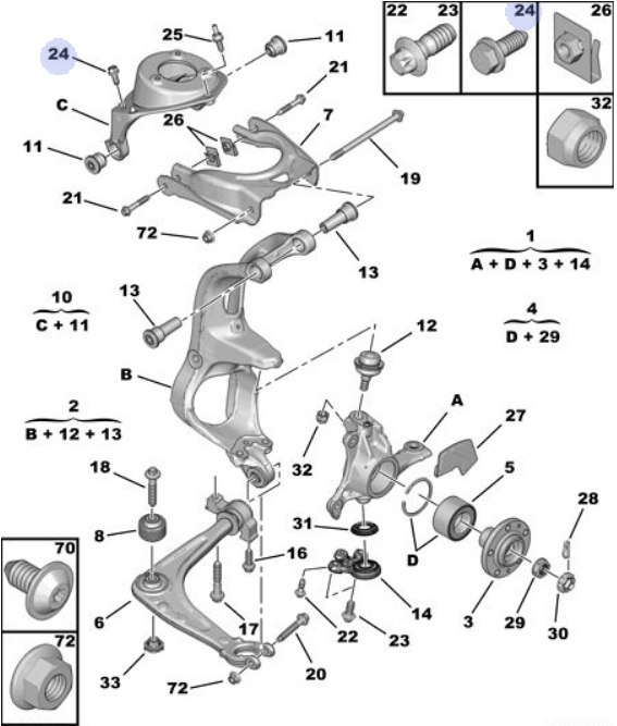

not sure what to call this joint/ bushing but its no.13 on this image, both sides needs replacing - http://c6owners.org/plugins/forum/attac ... 0_bush.jpg
front drivers lower ball joint needs replacing
both front lower wishbone bushing need replacing
rear anti roll bar links need replacing both sides
i wouldnt dream of touching the ball joint tbh but the other 3 are easy enough? if there is any guides on how to do them that would be great

Right that bush in your diagram is not available from Citroen. But you can buy it cheaply on the aftermarket. I've just had mine done a few months ago - I was getting a clunking on take off and occasionally braking. It was hard to diagnose as you really needed some weight on it to make it move when on the ramp.
But it's that back and forward that causes the clanking on the wishbone.

cheers marcGiveMeABreak wrote: 03 Oct 2019, 18:39 Right that bush in your diagram is not available from Citroen. But you can buy it cheaply on the aftermarket. I've just had mine done a few months ago - I was getting a clunking on take off and occasionally braking. It was hard to diagnose as you really needed some weight on it to make it move when on the ramp.
is there anywhere i can get part numbers for all these? it would make it a bit easier to source them, ive been dealing with japanese cars for a long time some of these suspension parts have like upper lower and middle on the same thing lol i want to make sure im getting them right
the one pictured can i do that easy when i take the load off the suspension as in wheel off the ground or will i have to compress the spring to change it?
the rear arb links should be easy to do and i should be able to rig up a pullers to take out and pop in the lower wishbone bushing am i right in saying that? or am being naive about it

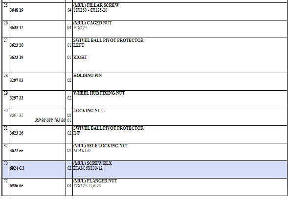

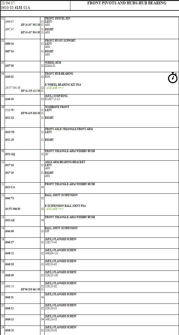

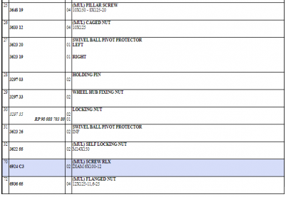

You'll have to click these to zoom them.
I do't do any spannering myself anymore, so had my garage do this and replaced the wishbones at the same time and the drop links.

Where a number has RP at the beginning, that is a replacement part
