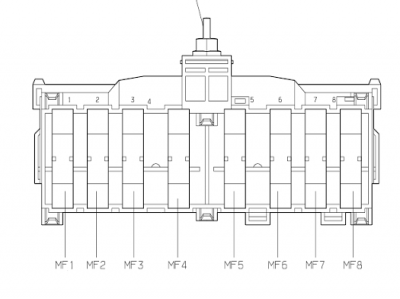

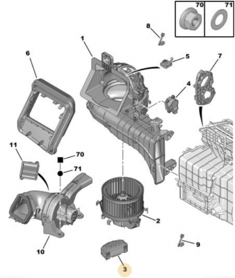

So this is your setup: Item 3 is the Blower control module for reference - however, this is supplied directly by Maxi Fuse 6 in the engine fuse box.
So I would check Maxi Fuse 6 in the engine fuse box - this is a 50A. So if there is no power to it when connected it could be the maxi fuse that has blown. MF6 does not seem to supply anything else.
I don't really recommend a direct wire up, as this system is linked to the A/C ECU control and the BSI via the CAN network and may have implications down the line....
Try to see if you can identify the cause first.

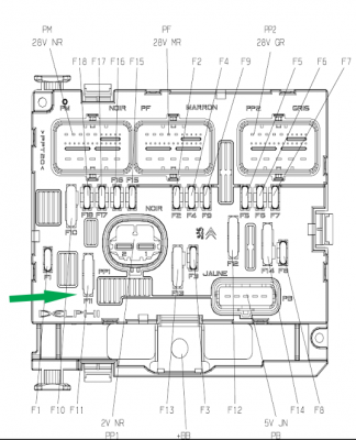

Ok, so if we know the blower motor is working under direct control - there must be an intervention in between that is preventing the power getting through. A diagnostic with diagbox would probably help at this point, given the tight integration of the system with other components.
Here is the wiring diagram for the heating system for your Picasso.
8045 is the actual Blower Motor.
Wire 8018: blower control module requirement
Wire 8019: blower control module diagnosis
Wire 8020 : air conditioning motor control
Wire 8020 above goes to 8048 which is the Blower relay
Wire BF01B: is the wire that goes to Maxi Fuse 6 that you say you checked as being OK.
Wire BM11B: (11 fuse server unit) is the internal relay (R7) of the engine fuse box.
Looking at the diagram again - I can see that Fuse F11 in the engine fusebox is for the blower relay So definitely worth checking that. It should be easily accessible and is located here where I have arrowed it in Green:
