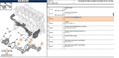

Post your VIN up so I can get you some details of the cooling system, which is what I think you want.

And yes that's exactly what I need a diagram of the coolant system would be amazing

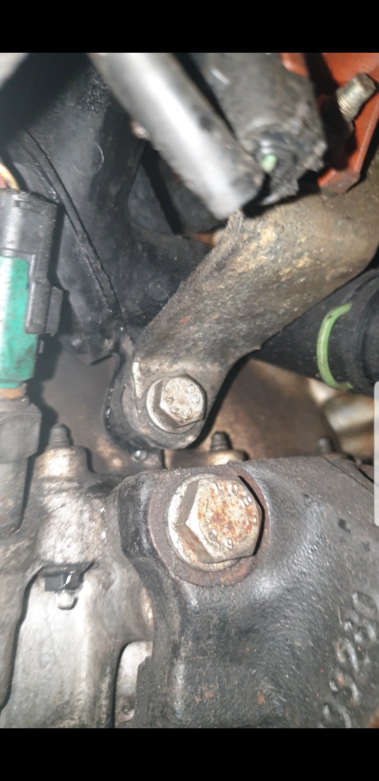

Just to update I decided to throw some k seal in ( admittedly knowing it's not the most trusted product) hoping for the little leak to heal which it did for a little while until POP all my coolant started instantly leaking out from under the engine.GiveMeABreak wrote: 26 Sep 2019, 10:06 Post your VIN up so I can get you some details of the cooling system, which is what I think you want.
Decided to take car to a friends garage which is where it's currently at with the sub frame and few things stripped off it's the plastic housing that connects to block the coolant expansion pipe goes into the same plastic housing, it kinda goes across the back of the engine.
Seems like it's going to be a big job to get that replaced.
Will take a picture of the plastic housing tomorrow but here's one of the part prior when it was only leaking.

Thank you so much for this really appreciated that exactly what I needed will get the part of dealers.
