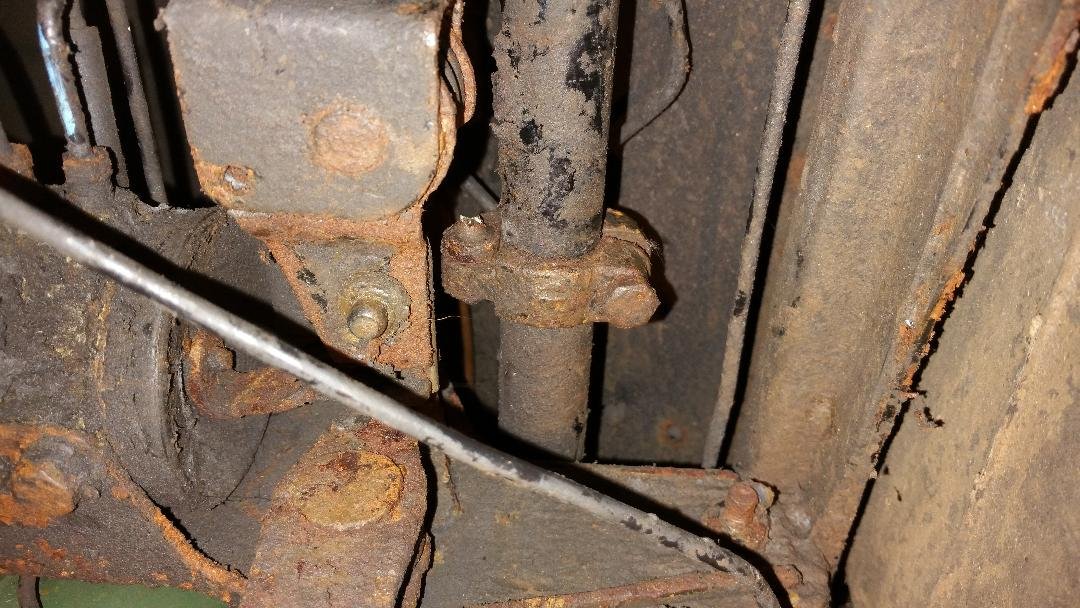

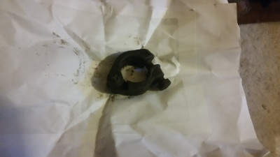

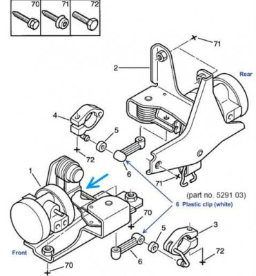

Thanks for responses, it is simple but not that simple.
Have now got under my Xantia and yep the dogbone is missing, but also the 2nd nipple on the arm of the clamp (Rear height corrector link rod clamp and arm) is also missing, snapped off probably.
Part is detailed as Part number 4 in the following detail: I also have some pics of it in place and off the car. Have been trying to source the part new from anywhere, not having much luck.
Have found a Mk2 Xantia being broken near Cheltenham, so can prob get part 2nd hand if i have to.
