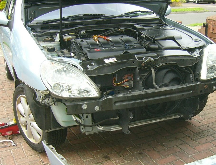

My daughter used to have a Xsara and I've had the front bumper off a couple of times - so it can't be too difficult.
Because of its size, it's much easier if you have a partner standing by.
According to the properties, this pic was taken in 2009.

The front bumper has to come off, then the cross beam shown in the picture needs to be removed. Two bolts each side. The bottom bolts holding the headlights in place are behind the cross beam.
