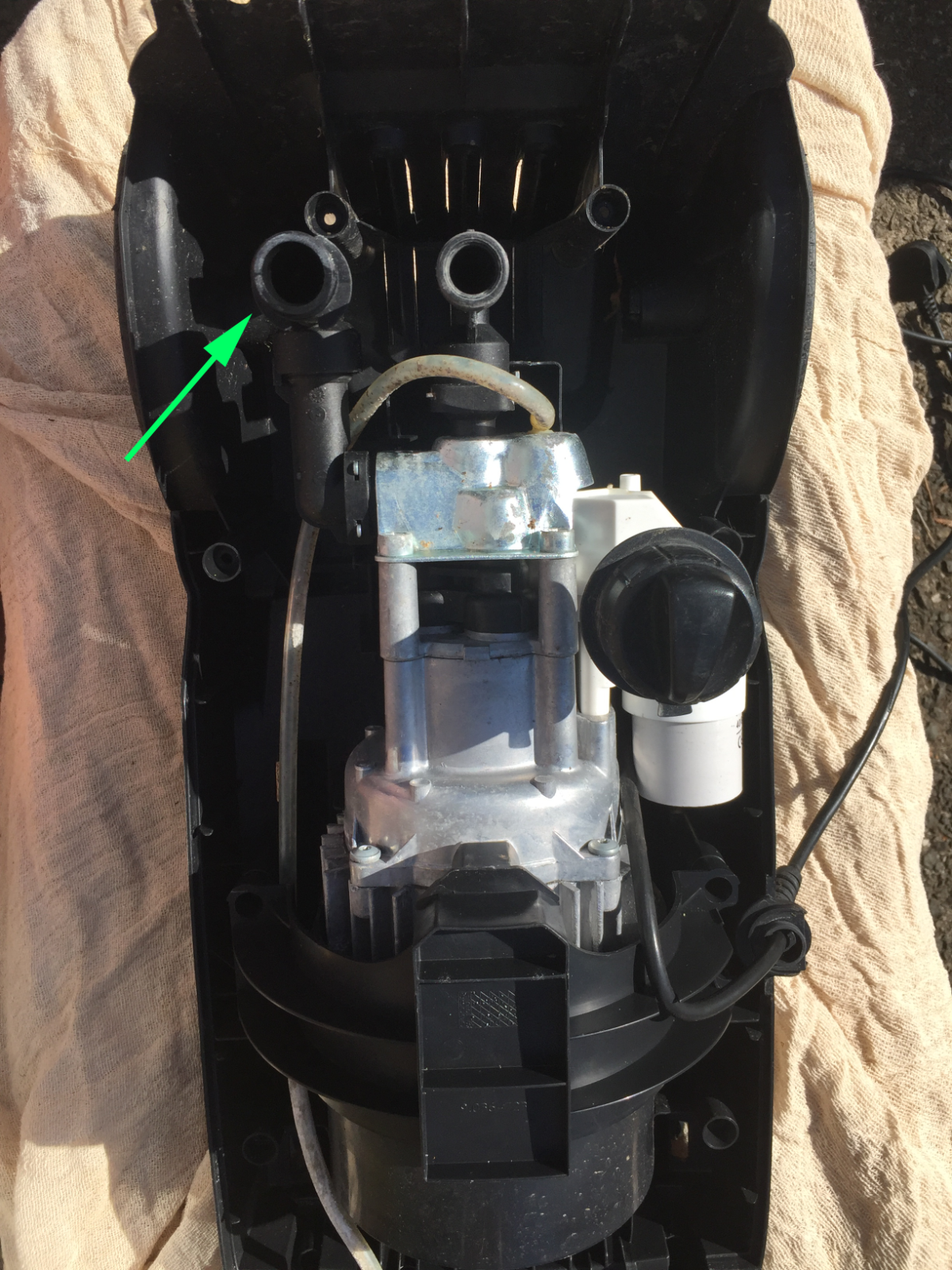

Went out to clean the paths and patio yesterday with the Karcher Pressure Washer - all going swimmingly (literally) using the patio cleaning attachment when I began running out of hose.
So decided to connect the big hosepipe reel up. Disconnected the small hose, unwound the large one and shoved the connector onto the pressure washer and off I went - or so I thought. Almost instantly I heard a gurgling and lost pressure. Switched on and off a few times to no avail. Checked connections, no leaks coming from the pressure washer kink in the hoses - nothing. As we have these water stop connectors - I went off to get a spray gun attachment to test the water from the hose - and sure enough that was at full pressure.
So as I went to connect the hose connector back into the pressure washer I noticed this foamy substance inside the connector and then it dawned on me. A Slug had found it's way into the end of the hose connector and I of course just locked and loaded. We have been invaded by the Giant Spanish Slugs - the 6 inch voracious monsters with no natural predators:
So next step was to take the Karcher to pieces and try to de-slug the internals - a prospect I was dreading. Now as usual got the torx set out and all the tools and went about removing the cover. Turns out you can take off 3/4 of the tamper proof screws - but good old Mr Karcher has made the last 4 so deep that your normal driver is far too short to reach. So annoyingly I went off to Amazon and got a new set of long drivers not to be outdone and they arrived this morning.

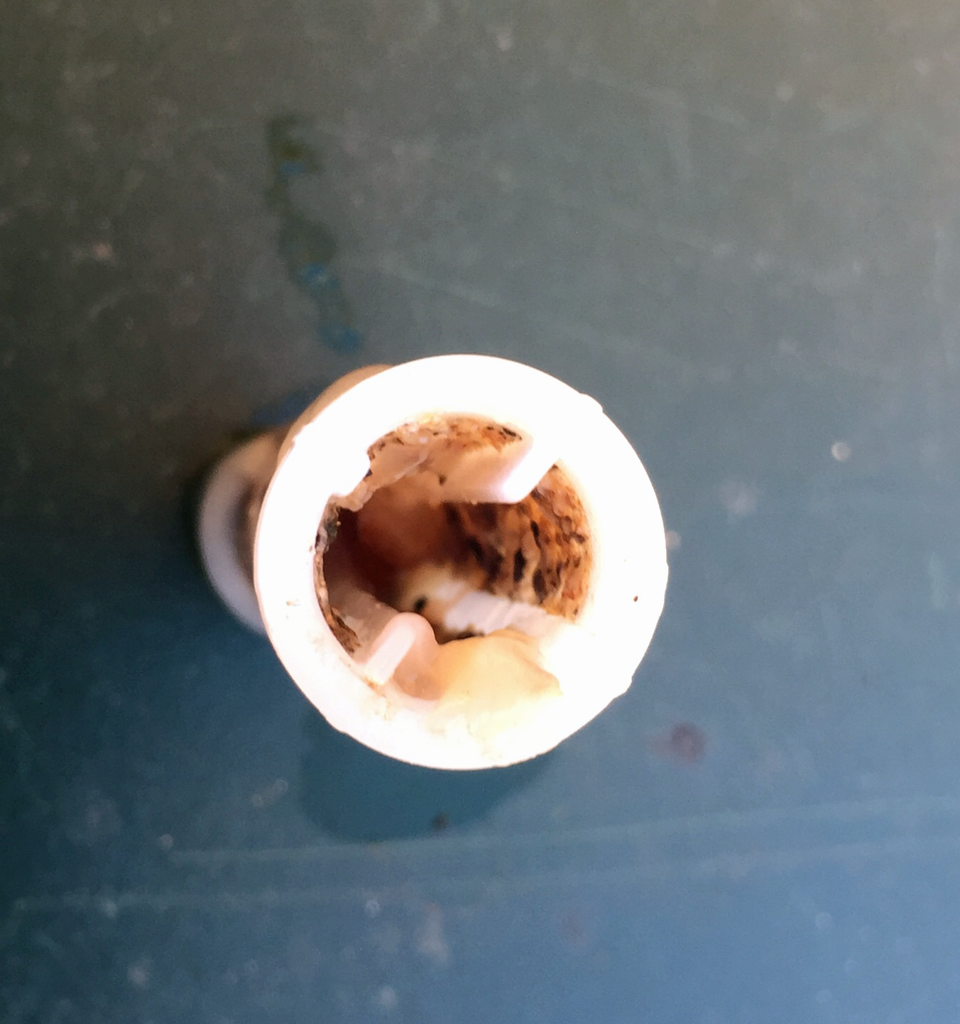

Off out with a vengeance and took the rest of the screws off and sure enough inside the plastic filter was what looked like a load of sand:
This is where the filter was removed from.... This is what greeted me - a real slimeball fest: After an hour of trying to pick out the gungy slime (ever tried getting monster slug slime off your hands?) and soaking it in turps, I managed to get it all cleaned out.
Just off to reassemble and hope the filter has done it's job - and if Gordon Ramsey is reading - if you have any gastronomic slug recipes lacking in prime ingredients - feel free to come over and help yourself.

Why didn't you just soak the filter in salt water?

I did use a combo of salt water and detergent and had to pick the slime out with a large needle - these Spanish Slugs are almost indestructible. But I really needed to get the rest of the pathways done and to see if that was the end of the damage. I can happily report back that all is assembled and I got the job done.
As for your detergent issue. The detergent suction only activates at low pressure. So if you have the vario-lance shown below, you need to twist the flow rate to minimum. This will allow the detergent to spray out and coat the vehicle or whatever else at low pressure.
If using the car brush - again there is a control that allows detergent mode or not:
So unless you have an attachment that restricts the flow to a low enough pressure - the detergent won't get mixed with the water.
