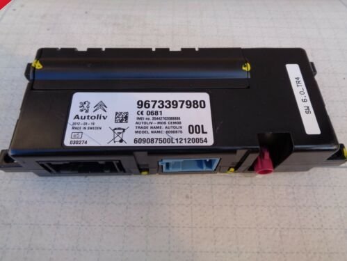

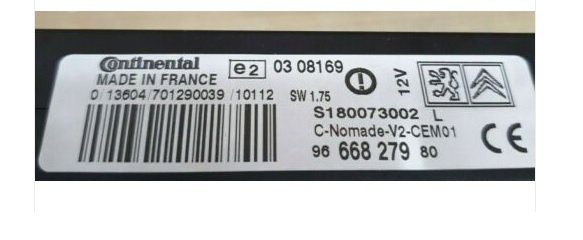

I have seen the attached module for sale on ebay, is this the right module for my car radio and do i need anything else.

Not necessarily. Early models had a separate hands few kit as you illustrated, but later models had it built in to the head unit if you have an RD45.
Post up your VIN and I’ll tell you what you have.
