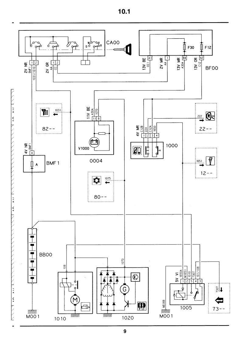

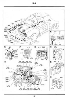

Right, checking some wiring today for silly slow starting fault . Firstly how do I get the big body connetor behind the drivers head light out ? (Pic) also could slow starting have anything to do with the ignition switch maybe ? Thinking of things I can check , also I'm prob being stupid but I can't see how the starter is switched on ? Lol there's two wires ones neg and positive with the car sat here doing nothing ?

Re: Can I have a wiring diagram please ! Xantia
Post by white exec »
Hi zs,
Starting diagrams (for petrol auto) as follows:
If you have slow/sluggish cranking with a well-charged battery, also check the main battery connectors, and clean up the contact surfaces.
If either main battery connector gets at all warm after a bit of cranking, the connectors are best renewed. The original lead (Pb) lump connectors develop internal resistance with age, and lose their grip on the cable. To replace, cut off the old connector, and clean up the copper multistrands back to bright metal. Solid brass connectors are the best bet.
Post by ksanturion10 »
Hi,
zs&tas wrote: 23 Sep 2019, 09:58 Firstly how do I get the big body connetor behind the drivers head light out ? (Pic)
If you didn't do it already, you must push upwards the grey plastic part over the brown plug and simultaniously pull it to the back. Becareful, as it is fragile, first try to make it move freely upwards and after that try, little by little, to pull it. Actually this is a 30 pin brown connector with locking. You should have similar one at the opposite side of the engine.
