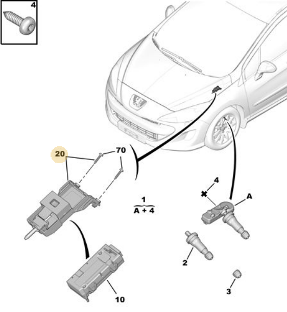

Ideally I would need a fault code - any fault will be logged in the system - then I can help you towards the issue - but without it just a guess - the standard generic causes for the "Wheels Not Monitored" message is:
- Deflation detection ECU
- Wheel transmitter module
- Radiofrequency aerial

Took the car to Peugeot 2 weeks ago and after checking everything they took the receiver out and said it was the receiver unit that was faulty. new unit was about £200. They ordered a replacement for delivery in a few days but when I came to collect the car the technician had put the unit back in and said that it was now working by some miracle and have cancelled the order.
So 2 weeks later the system is still working and it cost me nothing at Peugeot (that never happens to me)not even the diagnostic charge so was well pleased.
