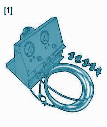

Ok, so I'm not sure what facilities / equipment you have, but this is the method used to check the brake compensator:
Preparation
Vehicle in running order.
Brake system bled.
Place the vehicle on a four-column lift.
Connection of the checking equipment [1].
Connect:
The front pressure gauge to one of the front brakes
The rear pressure gauge to one of the rear brakes
Replace the bleed screws with the sensors.
Bleed the equipment (refer to the equipment instructions).
Chock the front wheels.
Place the rear wheels on scales.

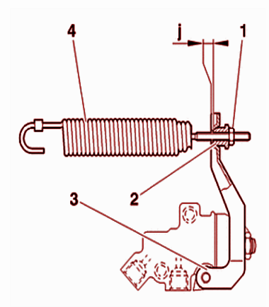

Adjustment
Unscrew nut (1).
Load the suspension to the load which corresponds to 1 person(people) + 5 litres of fuel.
Establish a pressure of 20 bars minimum in the compensator.
Screw the adjusting nut ( 2) to the stop on the lever (3) while ensuring that the spring (4) is not under stress.
To do this, a shim will be used to set a clearance ( j) of 1 ± 0,5 mm between the nut (2) and the lever (3).
Support the adjusting nut ( 2) and lock it in position using the locknut (1).

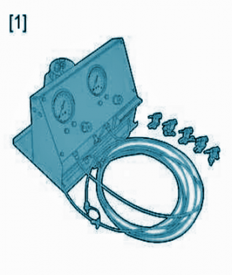

| Brake Pressure Checking Equipment (4140-T) |
Brake system bled.
Connect:
