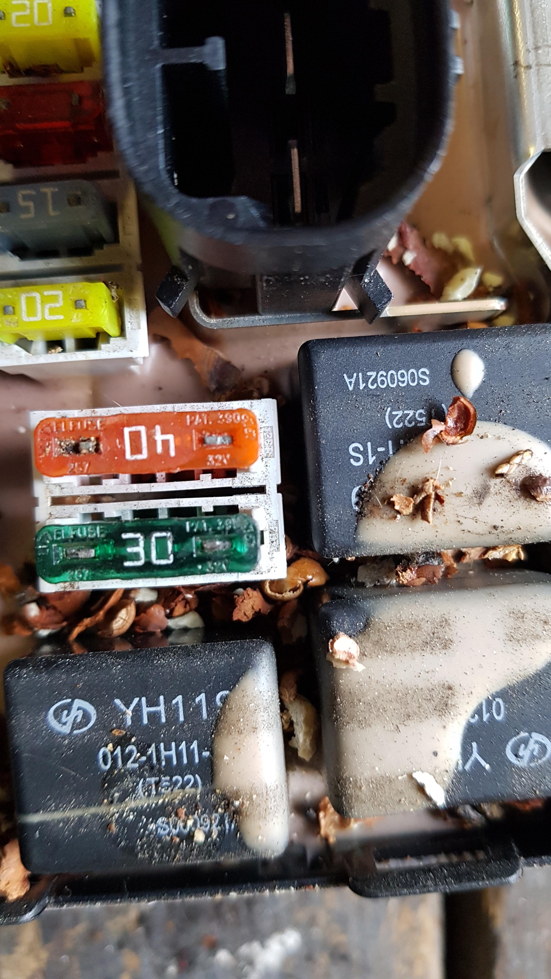

That was one thing I kept an eye on. It did have a slight gap, but no water got into the fuse box that way.
Tree's on the other hand somehow managed to allow their tree stuff to infiltrate...
This was as bad as it got. No actual water flowing as such, but the damp parts collected and built up a bit of damp enough to affect the fuses, which I dealt with.
As you can see the fuses were a little grotty.
The loom itself is in good order and the grease at the ABS pump kept water out there too.
