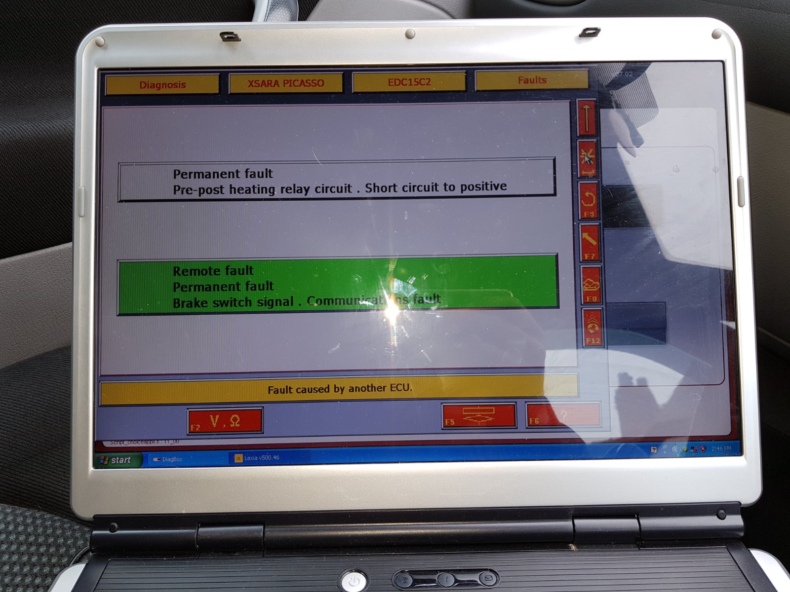

however i do have this fault on lexia......
![Image]()
wheeler
- Posts: 7930
- Joined: 21 Sep 2002, 19:07
- x 1055
Re: cruise control
Go into live data & see if the ECU can see both brake switch circuits working.
