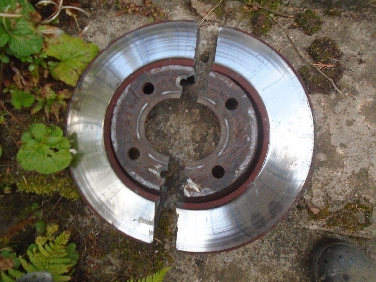

Re: siezed xantia break disk securing screws (torx) - any ideas?
This is your ultimate solution if all else fails, (to be honest I go for this at the least provocation)pseud wrote: 07 Sep 2019, 18:02 Hi Folks
I think the subject line about says it all - very frustrating moment - never had trouble with these (but, not had a lot of experience either). The torx splines have all sheered and I bashed in a hex-key impact bit and then that just made a nice neat little circle in the middle of the screw head when I applied some force...
Does anyone have any little tricks for this particular irritation? I can see myself drilling off the screw heads and then being stuck wondering how to get the screw sans head out of the hub...
Many thanks, Morgan
From the toolbag tales thread
NewcastleFalcon wrote: 14 Sep 2019, 20:31 Make two cuts through the disc opposite each other with an angle grinder
Put a large screwdriver/cold chisel in the top cut and hit with a hammer...hey presto
Worked yet again for me today
