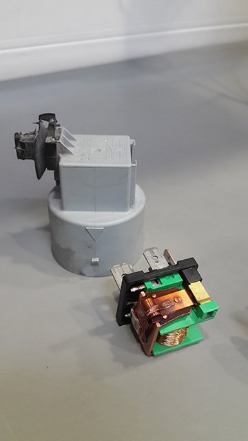

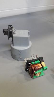

Hello there. First of all, I apologize for my bad English. I have a radiator fan problem in my vehicle. The fan does not operate when it reaches 90 degrees. When it is 100 degrees, all the overheating lights on the console are lit and a warning sound is heard. That's not always the case. Sometimes it works. When it works, it works at fast speed. I tested the fan relay in the photo, it works. But the fan usually does not work. I can not take the test because it is too expensive new radiator fan in Turkey. Is there a method I can test?

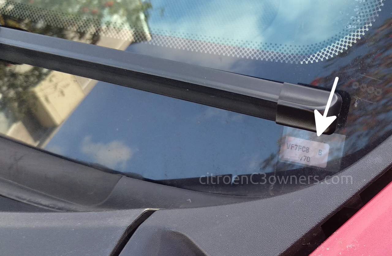

Post your VIN up so we know exactly what you have.
canbulatemre
- Posts: 20
- Joined: 07 Sep 2019, 07:43
- x 2
Re: C3 - 2005 - SX - Radiator Fan Problem
What exactly is VIN?
- x 6945
Your vehicle identification number.
You can find it on the outside lower corner of the windscreen in the little window cut out. It will begin VF7**************[VIN obfuscated, can be read by forum staff] and is 17 alphanumeric in length.

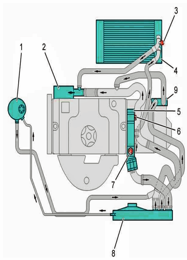

Ok, so here is the information regarding the cooling system fitted to the C3 MK I with AL4 Automatic box:

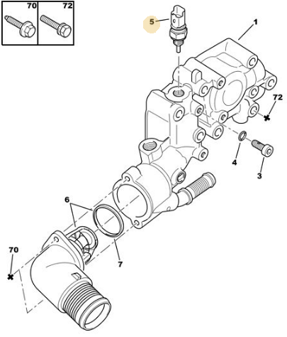

I would suspect the Thermostatic Water Temperature Sensor is bad, so try replacing that.

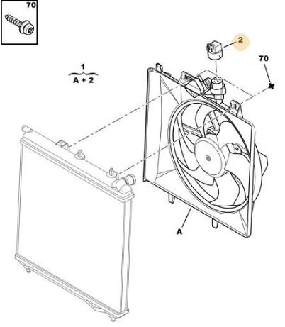

Item 2 is the electric Relay for the fan. Citroen Part number: 6555VL (45 Amp, Grey)
Item 5 Is the Water Temperature Sensor
Part Number: 9636777180
Cooling System Circuit Key:
(1) Expansion Chamber.
(2) Coolant Pump.
( 3) Heater Matrix Bleed Screw.
(4) Heater Matrix Unit.
(5) Coolant Outlet Housing (BSE).
(6) Coolant Outlet Housing Bleed Screw.
(7) Thermostat.
(8) Cooling Radiator.
(9) Heat Exchanger (automatic gearbox).
(2) Coolant Pump.
(7) Thermostat.

I tested the fan relay and it works. Engine water reaches 100 degrees. I checked it with the OBD. The relay is activated when the fan should run, but the fan does not start. I put the relay in and out a couple of times. He's working. This doesn't always work.
