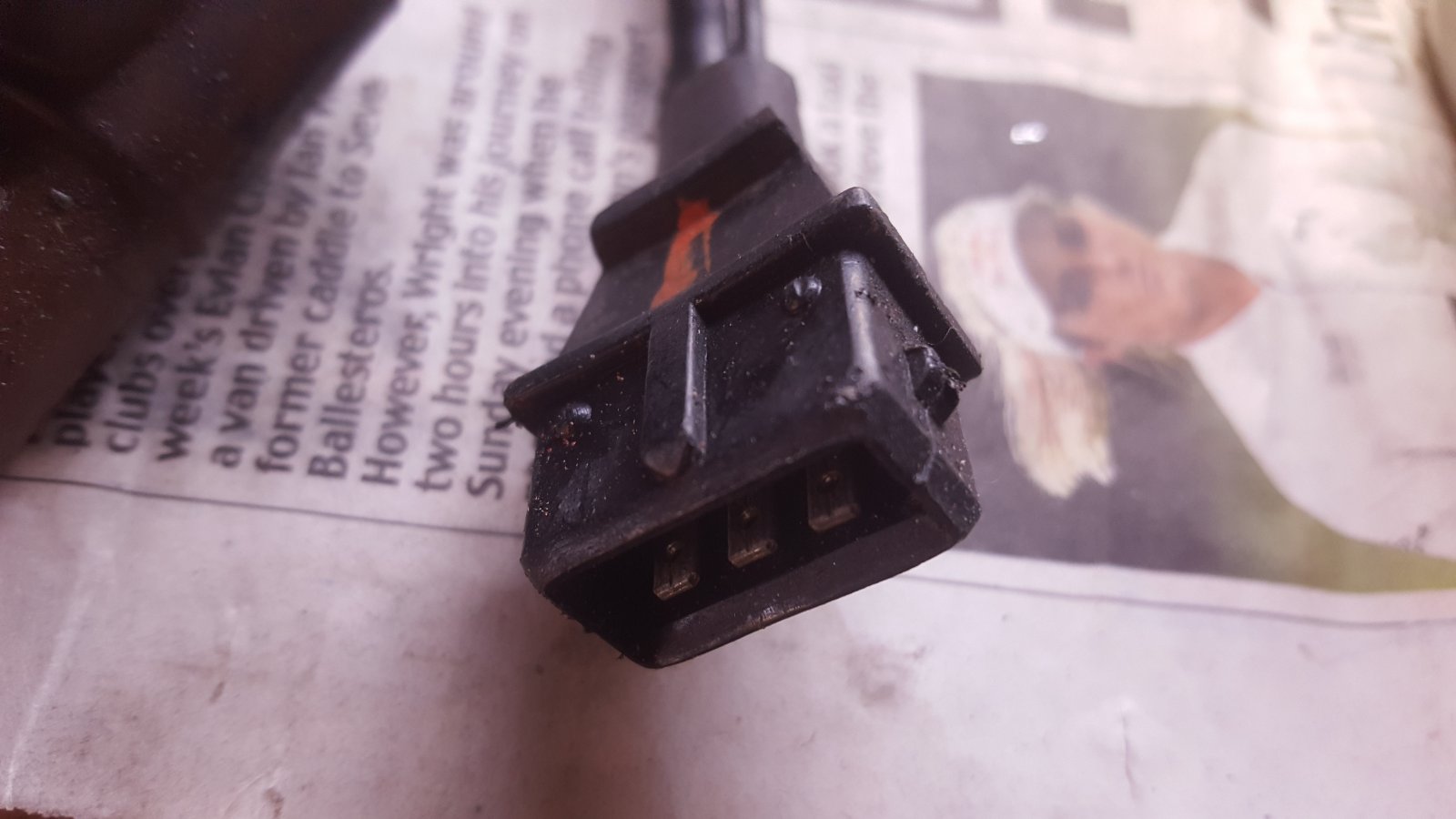

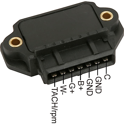

I believe this is the ignition module I'm talking about.. a 7 - pin flat plug connects to this and it's this plug I am seeking. The other plug needed is a 3 pin type that's similar and it's used to connect the other end of the loom to the distributor. A more familiar 3 pin plug that has one or two 'keyways' in the moulding. I'll get a picture later.

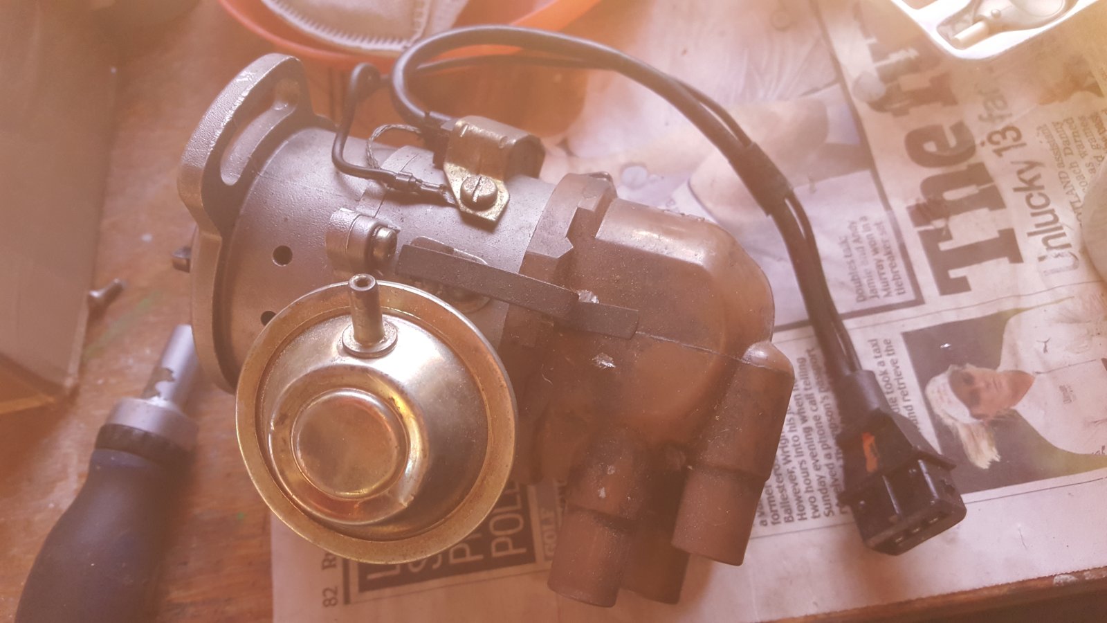

And here's a picture of the distributor with the corresponding 3 pin plug. I've searched a good few PSA plugs but they all seem to be the more recent types. Nothing really certain to fit this. I'll admit I've only skimmed a search though.

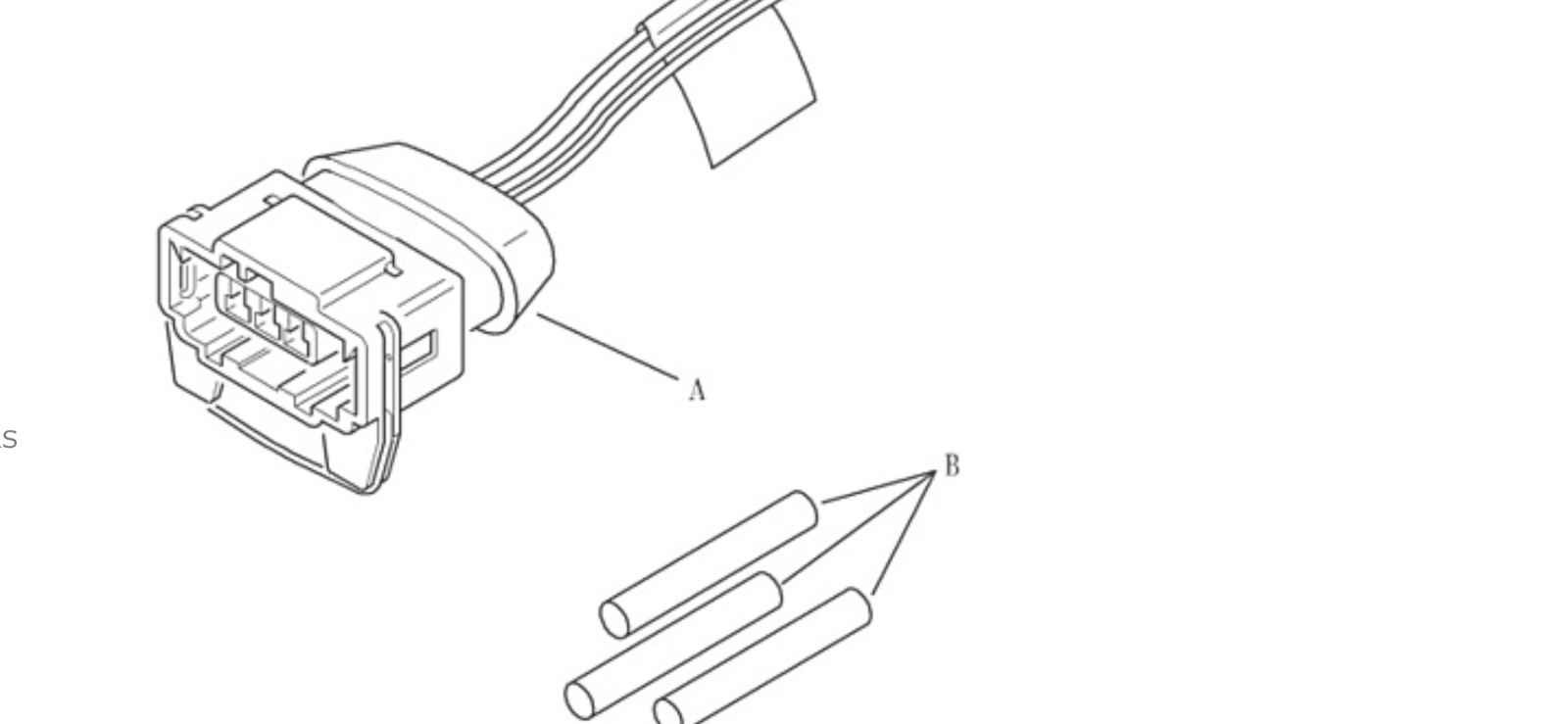

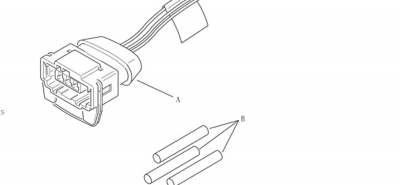

The 7 pin one is part no 96010936 but is showing as NFP.
There is a 3 pin repair connector (comes pre wired) part no 6544TY this is showing available.
The key ways may not be exact so may need slightly modified.

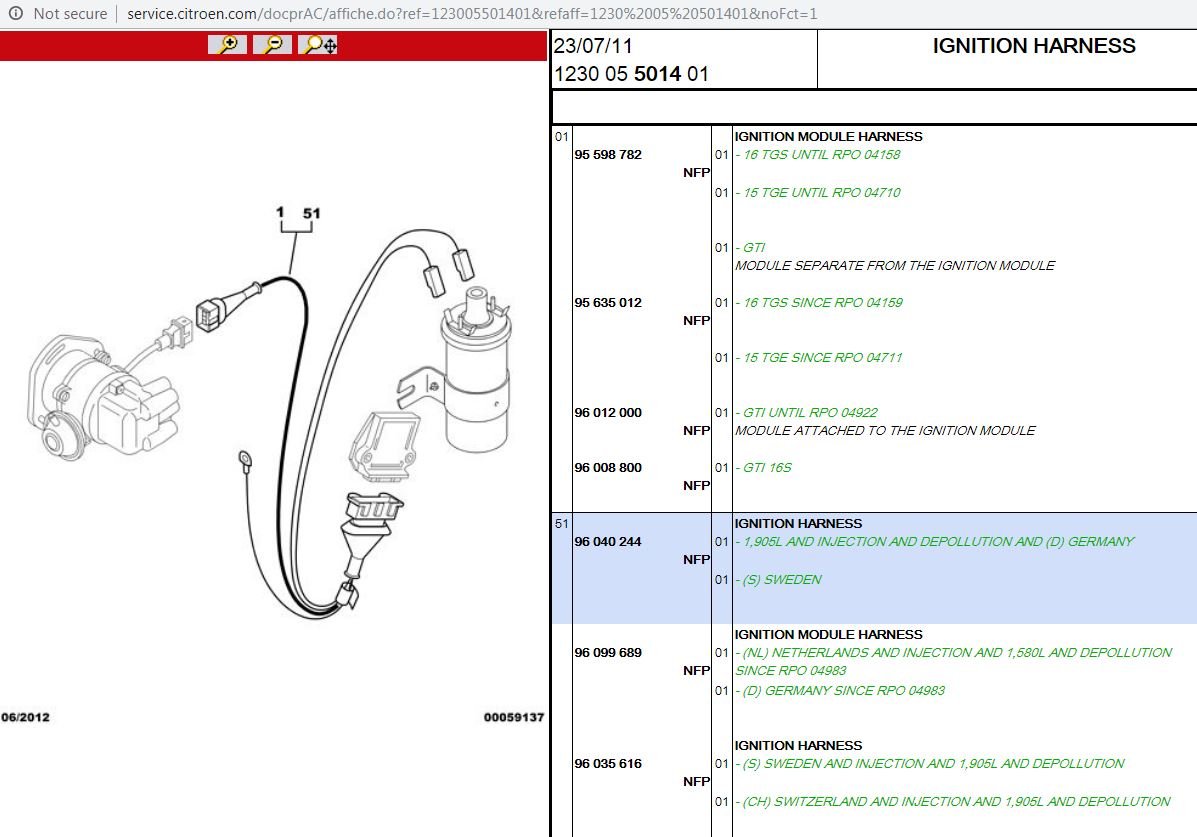

Was looking on Parts for one of those 7-pin module connectors, to see what cars (for scrap search) it might have been fitted to. Couldn't locate the connector on its own, but did find this complete lead for BX.
Lots of varieties of it (all NFP) - presumably with connection differences.
Looks like 3-way at the other end.
Do you have one of these leads that is repairable, or has it been lost?
