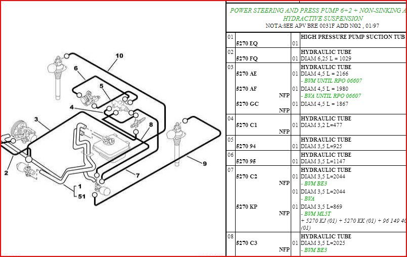

My off line version gives this however, it will be item 3:
V6 appears to be the shortest one, so one from another car would do, but it will be *much* easier to fit a Kunifer one. Just order up a 1.9m length and away you go. I still reckon getting the end on the security valve is going to be a mare....might be worth asking David as he repiped an HDi, and I recall he had trouble in this area. Potentially if the rest of the pipe is good, and you can get a joiner you could flare the pipe under the car and graft a new piece on.

I did come across that diagram in my original searching but there is nothing in it to confirm that the coiled up pipe is one of those ?RichardW wrote: 04 Sep 2019, 18:53 Still can't get onto the on line version...
I was under the impression that it went to the flexible hose which then goes to the hydraulic pump, but maybe I'm wrong.
I'll have to remove the air filter assembly (Ha! Step one in every V6 job
Assuming the pipe does go to the security valve instead of the pump...I don't know where the security valve is on the V6, I'm guessing down the back of the engine...
However unless I had a complete replacement pipe there would be no point in going all the way to the security valve since it would need joining downstream instead. Two compression joints and a new coiled section wound from cunifier will be a bit clunky looking but I suppose if it does the job to keep an old car on the road...

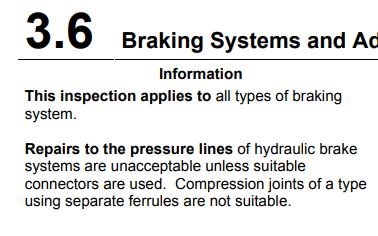

Don't use olive-compression joints for repair work on Citroen steel hydraulic lines, despite some advertisements for these.
The pressure of 170bar+ is beyond the capability of this type of joint, and the olives do not make sufficient indentation into the steel pipe (as oposed to copper or cupro-nickel) to hold firm. This type of joint was specifically prohibited (by UK MoT testing regs) from use in repairing brake lines.
The 'olives' used in Citroen HP pipes are formed from a swage of the steel pipe itself (plus a sleeve rubber).
I'm sure the pipe details can be identified when we get access to Parts again, and an outfit can be found to make one up, if NFP.
That type of joint would only be appropriate as a temporary measure, eg to allow the car to be put on a ramp for repair.

When I look up pipe 3 specifically for my VIN it gives a match for 5270 GC - so assuming this is the pipe in question it is definitely one of the two that is NFP. So repair, after market or 2nd hand replacement looks to be the only option.

I wasn't aware that olives had to actually bite into the pipe they are sealing to be effective ? Surely the point of an olive is that it is soft enough to deform between the taper in the nut and the pipe to take the exact shape of the gap between the two thus form a seal. While the pipe of an olive joint does typically deform slightly I'm not sure that's necessary. Likewise a rubber o-ring seal works by deforming to the micro contours of what it is sealing and seals without deforming the host materials at all.white exec wrote: 04 Sep 2019, 19:40 Don't use olive-compression joints for repair work on Citroen steel hydraulic lines, despite some advertisements for these.
After all olive joints are used not only on copper plumbing pipes (which do deform under the force of the olive) but also on radiator end fittings which are chrome plated steel, which do not deform, and seem to seal just as well as on copper. To be fair, at much, much lower pressures than we're talking about here.
3.5mm and 4.5mm Citroen pipes don't use olives at all. The primary seal is a close tolerance fit between the outside diameter of the tip of the pipe and the inside diameter of the bottom of the hole, it's a tight enough fit that the pipe ends often get stuck in the hole. The secondary seal is the rubber sleeve, and the swage in the pipe is only there to give the nut something to bottom on.The olives used in Citroen HP pipes are formed from a swage of the steel pipe itself (plus a sleeve rubber).
I'll take your warning under advisement but I'm not 100% convinced that you are correct about the danger.
To be honest I'd be more concerned about trying to get an olive to seal on the scabby surface of an old pitted/corroded pipe. Like plumbing fittings the pipe would need to be clean and smooth to get any sort of seal, that could be a challenge on the old pipe.

Simon, it is the case that 'dry' olives do have to bite into the pipe involved to create a seal where any significant pressure is involved.
If they don't, all the joint has is friction to hold it together, and that is not good enough for our 170bar+ hydraulic systems. For plumbing work, where pressure is much lower (3-10 bar often), a brass (or steel) olive biting into a copper pipe is ok.
Citroen hydraulic joints with their integral bulge in the pipe rely on the bulge (with the locking tube-nut behind it) compressing the rubber sleeve into the inner space. These are clever joints, inasmuch as hydraulic pressure actually increases the strength of the seal by compressing the rubber. The pipe end, where it enters the inner drilling, does not form a seal on its own. The running order is: pipe end, rubber sleeve, bulge, tube-nut . . . in that order. I can post a Citroen drawing, if needed.

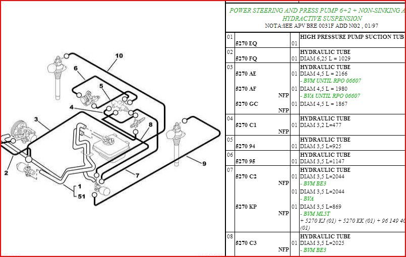

Finally got into s.c.....
Don't have your VIN handy to absolutely check
5270GC looks like it, and you can see the coil on this diagram:
The pipe length is listed there.
If you can identify the pipe ends, one of the companies who make up new Citroen pipework should be able to run up a pipe for you. You can wind your own coil in the appropriate position.
