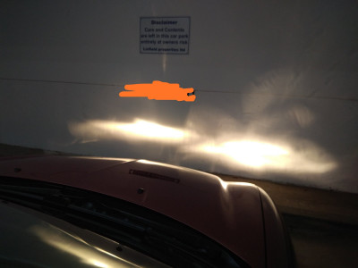

Just had MOT failure for lights. Passed last year and were not adjusted since, so I forgot to recheck them :roll:
See attached image. Can this be adjusted easily at home without the test machine?
Not sure what has happened. I believe that the bulb is seated correctly.
Failed for the o/s incase is not obvious from the image!

Unless you've bumped it, there should be no need to adjust the lights.... I would re-check the bulb as the image is all wrong. Is there an internal reflector that is bent? Is the bulb in upside down?

RichardW wrote: 02 Sep 2019, 12:24 Unless you've bumped it, there should be no need to adjust the lights.... I would re-check the bulb as the image is all wrong. Is there an internal reflector that is bent? Is the bulb in upside down?
Internal reflectors have not been touched and look fine. Bulb has not been moved since last year and it passed then so I can't see it having rotated in 180deg in the last year. I did notice that there were black scuffs where someone had side swiped the front of my car in a car park, but I didn't think it would affect the lights.

What was the failure - beam too high, or beam image incorrect? Presume this is a Mk2 with the bubble headlights? Are they badly yellowed - if so you might just need to polish them to remove the haze and restore the beam pattern.

RichardW wrote: 02 Sep 2019, 13:33 What was the failure - beam too high, or beam image incorrect? Presume this is a Mk2 with the bubble headlights? Are they badly yellowed - if so you might just need to polish them to remove the haze and restore the beam pattern.
O/S beam too low.

You can check the lights flat surface with a wall at the end. Drive up close as in your picture, then mark the wall where the centre of the lights falls. Drive straight back about 10 ft and you will see the beams on the wall, they should stay just about on the marks you have made. To me that pic looks like the beam patter is not right, rather than too low - see the NS beam has a clear defined line with a kick up at the LH end? The OS should look the same, whereas it just looks like a blob!! I would stick a new bulb in the OS and see what it looks like. These lights have electric levellers, and if this goes kaput, then it's possible the light will point in the wrong direction.

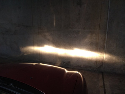

Sorted. Took the bulb it and then reseated it.
Looks okay now. I completely forgot to check alignment. Just checked they were working. Never thought it would be out of alignment :roll: .
Glad it didn't just fail on this.

=D>
That looks better :-D
